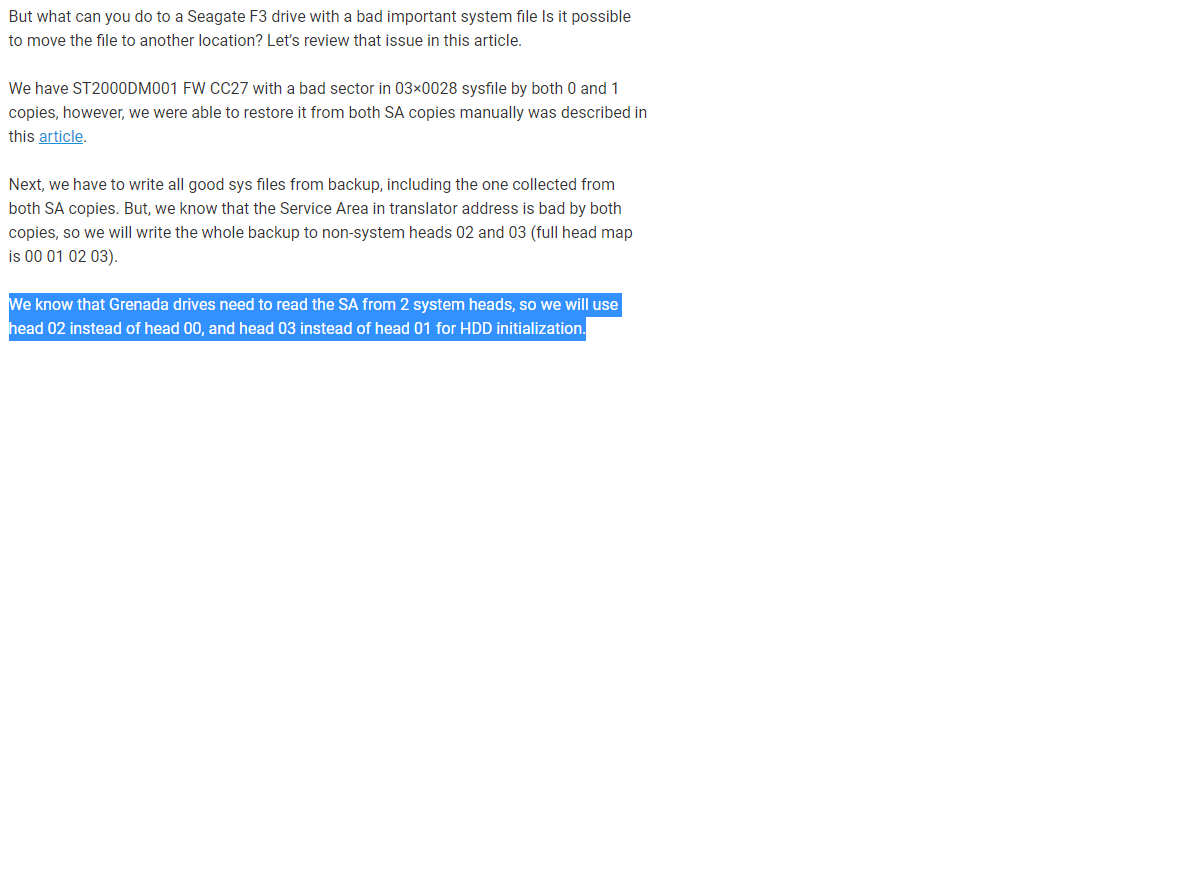

I work on a poor surface ocean (Bacall)
The surface of head 1 is in poor condition ...
I was able to make an SA backup and then my head died ..
I inspected the head under the microscope and saw that it was full of crap ..
So I cut the head, but after that I found out that both Bacall and Grenada need both system heads for start up .
is it not possible to change the system head on this hard drive if it missing head 1 even though I have a backup of sys file

The reason I ask is that I found it on one of the Aceblogg .. And I tried to edit the head map. when i do it the drive spins up and gives terminal error and the holder stays busy but it does not spin down again afterwards
try to change the heads map from 0 1 2 3 to 0 3 2 3. You need H0 to stay H0, don't change it to H3
