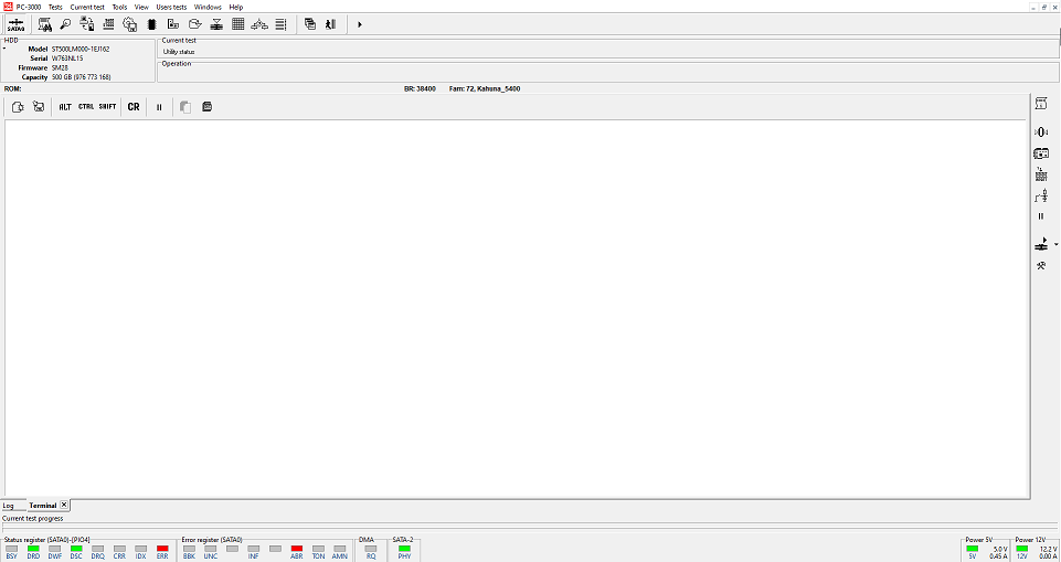

Hi I was working on this hard drive, it had stuck head. after loosening my head i connected it to pc3000 hard drive spins fine .. but it did not give id and give me this error in terminal:
Rst 0x40M
The servo processor is reset.
could this mean bad head? drive dont spin down just keep spinning..

Ok i got this drive to ID but thats all..
