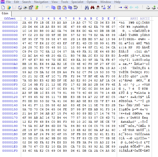

The drive get RDY with no mechanical noise. With Simple mode it shows bad sectors.
After applying the patch, backing up the SA, and edit saved mode pages module (SMP), from utility I tried to read the sectors but unfortunately it seems encrypted.
In DE obviously I can't browse the partition structure. In attached a screenshot of the MBR.
I know this customer uses MAC but a similar case never happened to me. I tried to ask to customer if the drive is encrypted but he told me that it doesn't appear to him.

Ok I managed to clone it at 90-95MB/s (edited SMP) and almost 100% only a few bad sectors.
Unfortunately there seems to be encryption that I have never seen in Seagate...do you know anything about it?
