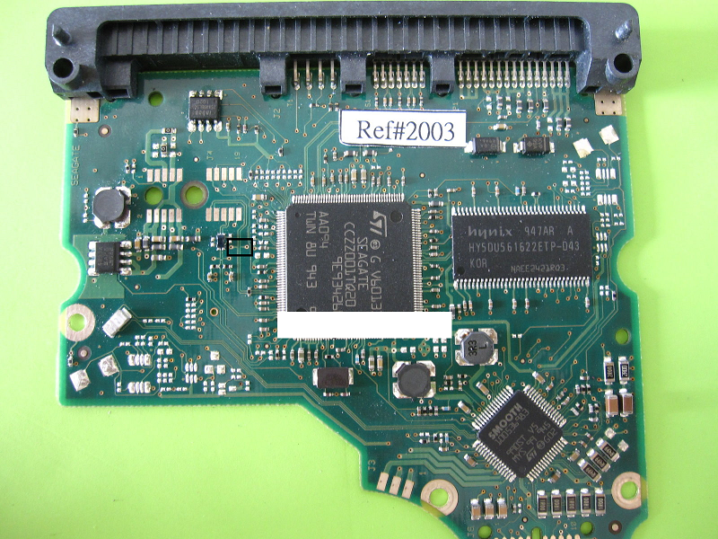

I got Seagate Barracuda 7200.12 1 TB (ST31000528AS) hard drive with board 100536501 Rev A ... On connecting its continuously remains in BSY state. I want to short it but unable to find the shoring point ... kindly help in find the shoring points thanks

Here

northwind wrote:Source of the post Here
thanks northwind ..... i was going for the same and recheck it again but shorting these point do not helping in getting the ready state ..... is there any other solution except these points.

Is there anything on terminal?

northwind wrote:Source of the post Is there anything on terminal?
There is nothing in the terminal as well

Nothing in terminal? strange.
How does the drive behave, clicking, keeps spinning, is serial in ROM matching the drive serial, whats the client story ?
