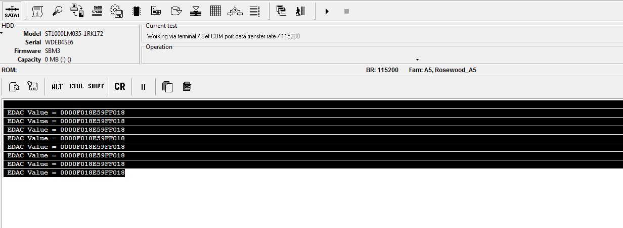

i have a model seagate ST2000LM007 mobile hdd. its shows id and correct size. but not able to read any sector. i can access terminal. when i press cntrl+L its shows " diagonstic port locked". please see startup log below
Boot 0x80M
Rst 0x80MSrv DETCR init 0x0000
EDAC Value = 0000F018E59FF018
(P) SATA Reset
RAW OFF
PASS
EDAC Value = 00000000FFFFF844
(DOS Table) Worst Count: 0000100C At SU: 00004C33 NT: 00000002 OT: 00000007
MCMT table is corrupted
Intel 6G->3G
Send Status: COMRESET seen
CSpd= 3Gbps
DSC
ASCII Diag mode
F3 T>
ASCII Diag mode
F3 T>
ASCII Diag mode
F3 T>
ASCII Diag mode
when press cntrl+L
F3 T> "diagonstic port locked"
HDD ID Display But LBA: 0
Solution :
Solution :

Re: seagate ST2000LM007 -SBK2 diagonstic port locked
I would ignore EDAC values but instead focus on 0LBA which is symptoms of a translator issue. You can unlock these models on PC3000, but there is a risk of data loss when clearing translator and associated MC data, so ensure a full SA backup is made before any attempts to resolve the translator.
