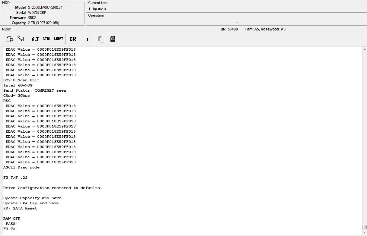

AJ2008- The command F,,22 worked, meaning that after refreshing ID I got the right capacity. The translator unfortunately I can not read it.

Re: ST2000LM007-FW:SBK2 - Rd Sys File 28 Err
Postby jojo2012 » 24.07.18, 09:41
Case solved. Cloned 99,9%.
PC3K had the solution and it was enough to exploit it.
Thanks anyway to AJ2008 and Amarbir for the hint / help.

So, executed the F,,22, which gave SA access.
All mods are fine, except 2B.
First 7 sectors of each copy in 2B are unreadable.
