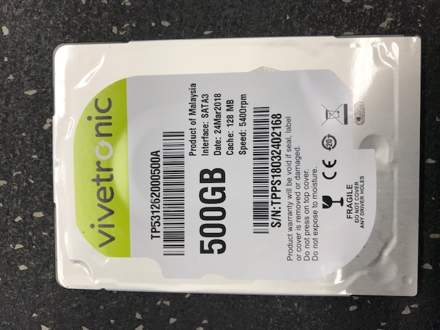

Picture attached.

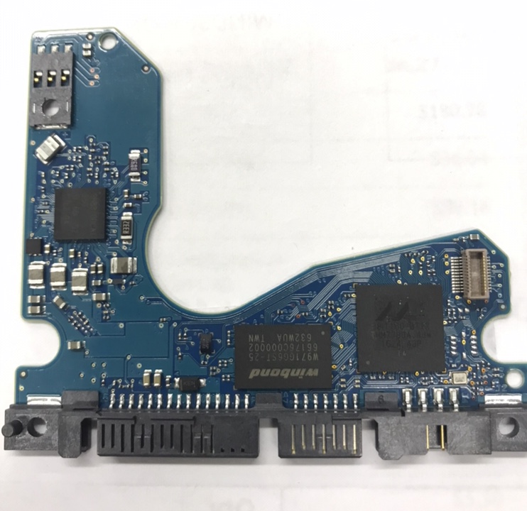

It has a Seagate 100781943 PCB on it, but I get no terminal output.
After clicking, Seagate utility identifies itself as: OOS500G128M.
Clicks, then spins down.

Have seen a few here of these TP53126200 500 GB. Actually 1TB Rosewood probably failed Seagate QC (did not know they had any)
Sold to vivetronic with lower capacity. Did not have any trouble unlocking it with Rosewood utility here.

It doesn’t seem to have a nand chip on it. It’s the only one that I could find that was 500 gig that had the same chassis. I tried a couple 1 TB that looked to be the same, but they did not work.
Re: Anyone heard of VIVETRONIC HARD DRVES? *pic
Postby digitalsupport » 15.12.18, 18:31
Your pcb looks like a 100781943 88i1160 from a ST1000LM035 or ST2000LM007
I have also registered 100809471 with 88i1164 on the same 2 drives ST1000LM035 or ST2000LM007
Just go and check ROM info to confirm family ID
