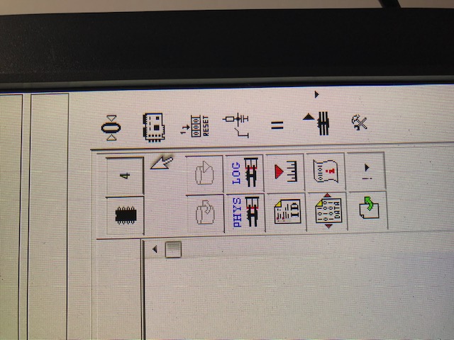

When you modify the logical/physical ROM on the menu on the right, in that same menu you will see an option with the number 1 in it.
If you click the number, it may change to 2 and sometimes 3, depending on the model.
Data Medics: Those numbers indicate which preamp you're working with?

Amarbir, here is the screen option I'm referring to.

I suspect that number there has to do with the fact that newer ROMs will actually have 2 (possibly 3) copies of the ROM code stored in the physical ROM package. I think you normally only need to modify the first copy though. The others are just a backup, but perhaps they give that option in case you want to modify things in the other copies for some reason (maybe if the first one is bad???).
I've honestly never seen a reason to bother with that feature.

Data medics, so you just change the logical heads with it set on 1 all the time and it works for you?
Re: modifying levels on F3 drives
Postby DataMedics » 20.12.18, 01:06
With Seagate, nothing "works all the time". These drives are as finicky as heck.
Mostly all I'm doing in ROM is modifiying the SAP control flags to start from only head 0 or 0 & 1. Or to adjust the logical head map in a case where I know which head is bad. That and to unlock the terminal locked drives. It's not often you need to do much more in ROM.

Based on my experience, ROM head map editing is not very efficient for families after Pharaoh or Grenada.
DataMedics wrote:Source of the post Mostly all I'm doing in ROM is modifiying the SAP control flags to start from only head 0 or 0 & 1.
I think it's the simplest and most efficient way for ROM modification on Seagate F3.
For some drives, logical head maps for preamp versions can be different, so we advise to change all of them, to be sure that the drive will start with a head map we set.
