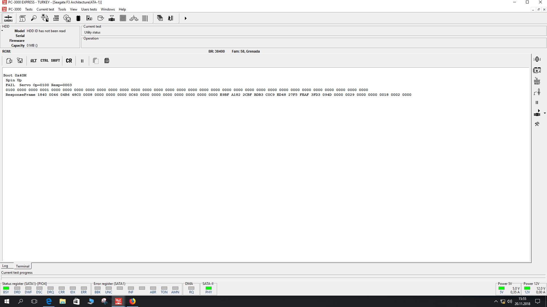

disk is 3.5 seagate ,disk is busy, What can be the issue
Blizzard
Posts: 96
Joined: 29.06.16
Re: busy seagate st2000dm001
Postby Blizzard » 21.11.18, 14:54
For DM series a repeating "FAIL Servo Op=0100 Resp=0003" and/or "FAIL Servo Op=0100 Resp=0007" is typically head failure. If head-0 has not failed you can sometimes gain access by editing the head map. Backup ROM before any modifications :)

Blizzard you're talking about that
https://blog.acelab.eu.com/pc-3000- ... maged.html
ok. thank you :)
Blizzard
Posts: 96
Joined: 29.06.16
Postby Blizzard » 22.11.18, 15:47
ankarakecis wrote:Source of the post Blizzard you're talking about that
ok. thank you :)
Yes, that looks like a good starting place for your case.
