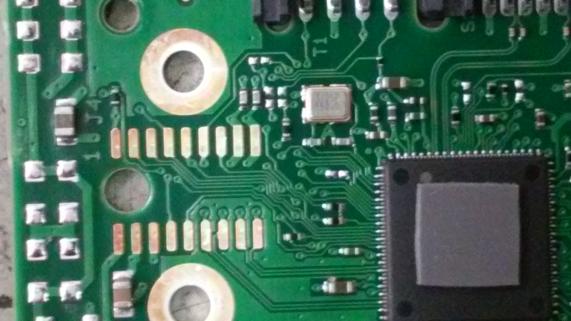

Would greatly appreciate short points on PCB 100721570 as per attached

Enlarge picture at top; short points are 6th and 7th from the top on the left row. It's been a while since I did this but If not 6th and 7th, then 8th and 9th. You'll hear clicking when you hit the right points.

... or power the unmounted PCB and measure the voltage to ground of the obvious trace pair you think is the read/write channel. The read channel traces will have 0v and the write channel traces will have a small bias voltage, e.g., ca .5v.
