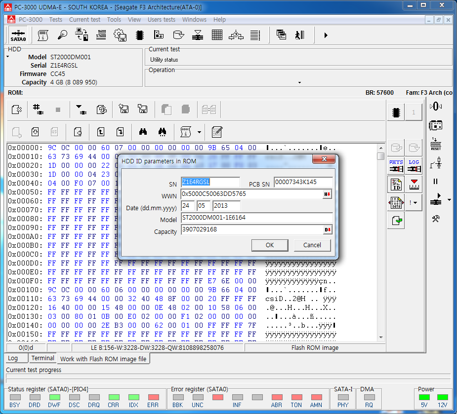

I have harddisk of Segate ST2000DM001, 2TB, recognized 4G wrong capacity.
I guess ROM info currupted.
Loading ROM image by PC3000 is ok.

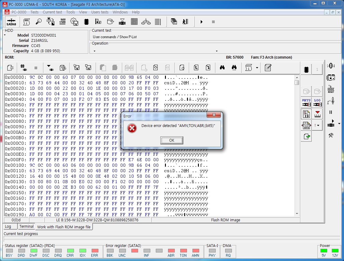

I adapted HSA setting (Go to Tools>HDD>Set max LBA)
A certain message was presented.
How can I do to fix the problem like this.

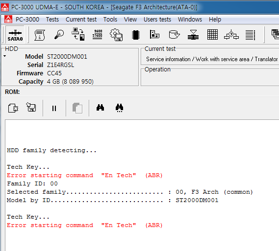

Start with a terminal log of what it's saying when the drive is powered up.
Re: Segate ST2000DM001 wrong capacity error
Postby AJ2008 » 30.04.18, 14:16
Probably it says error about Remaining in BootFW and recognized capacity is 3,86GB which was explained in other thread that was started on the same subject. I think terminal log will not be helpful.....
