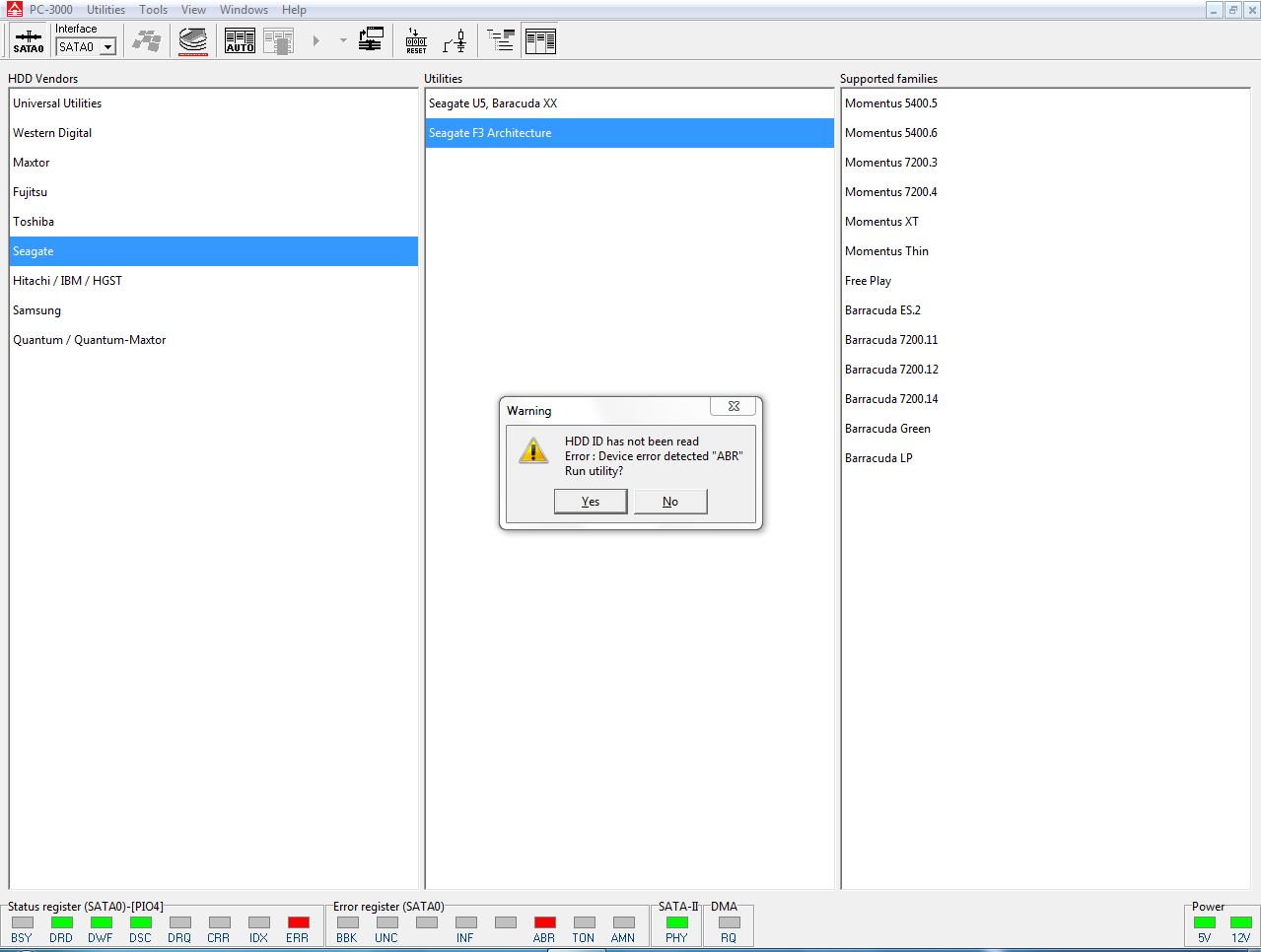

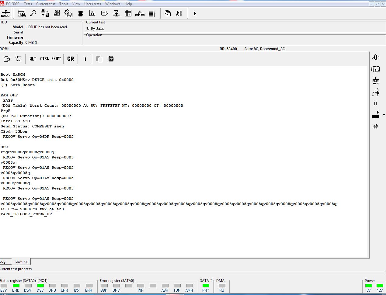

I have to handle this patient. It spin up with no clicking or other noise, and get DRDY DSC, but when I launch the utility I get the error in attached.
I have not applied the patch yet, because I’d like your opinion about the error I get in terminal.
To me that “RESP = 0005” makes me think a problem with the heads.

DWF - this suggests some mediacache issues. You need to unlock via ROM patching, and you can work over terminal and make repairs here also - note, the device will not work over ATA at all until you resolve this issue, so you will not reach good ID, or be able to work with modules table etc - use system files over terminal to gain access and repair - make sure important system files are backed up first.

Right AJ2008, meanwhile I'll try to unlock it, then I'll work with the system files as you said.
