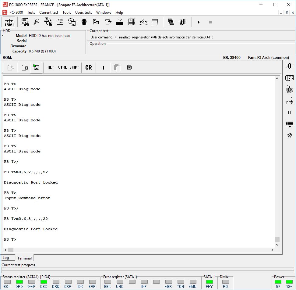

I have this drive Seagate ST1000DM003 PN:1SB102-500 FW:CC43
In the terminl, I get out : Diagnostic Port Locked
Itried to resolve the problem by the method in this article (http://blog.acelab.eu.com/pc-3000-f ... drive.html). But it still Diagnostic Port Locked
Has someone any idea to resolve it ?

Did you verify that the ROM actually wrote when you did the preparation? Perhaps there was a problem with writing it, and you're still working with the original.

Please send us terminal output after ROM patching.
