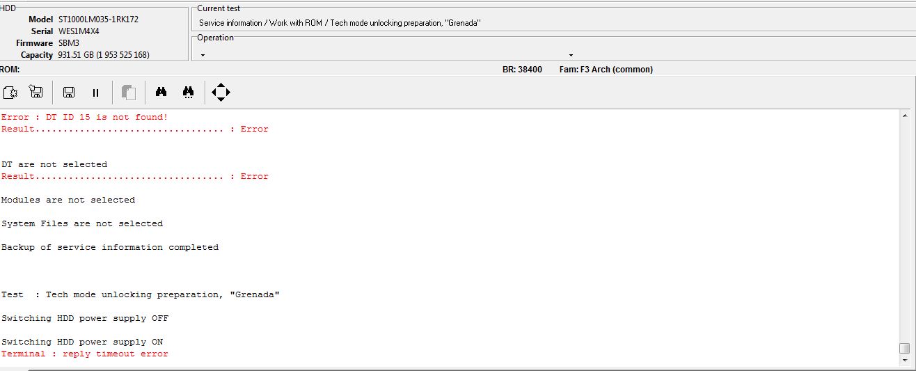

My Hard Disk seagate terminal Lock
F3 T>r93
Diagnostic Port Locked
http://blog.acelab.eu.com/pc-3000-f ... drive.html
Test : Tech mode unlocking preparation, "Grenada"
Switching HDD power supply OFF
Switching HDD power supply ON
Terminal : reply timeout error
Any Other Solution

I hope I'm wrong but I don't think PC-3000 supports ST1000LM035 or ST2000LM007 (Cheops Family?) currently.
