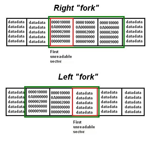

Then you can see two situations:
Right "fork" and left "fork".
Right "fork" - first unreadable sector contains bytes almost all zeros or sevens. After first unreadable sector could be similar sectors. Before first unreadable sector there are sectors with data.
Left "fork" - first unreadable sector contains data, but before it there is sector (or several sectors with almost all zeros)
You should add in translator sectors with zeros. In case of right "fork" - first unreadable sector (and probably several sectors afterwards), in case of left "fork" - sector (or several sectors) before first unreadable.
