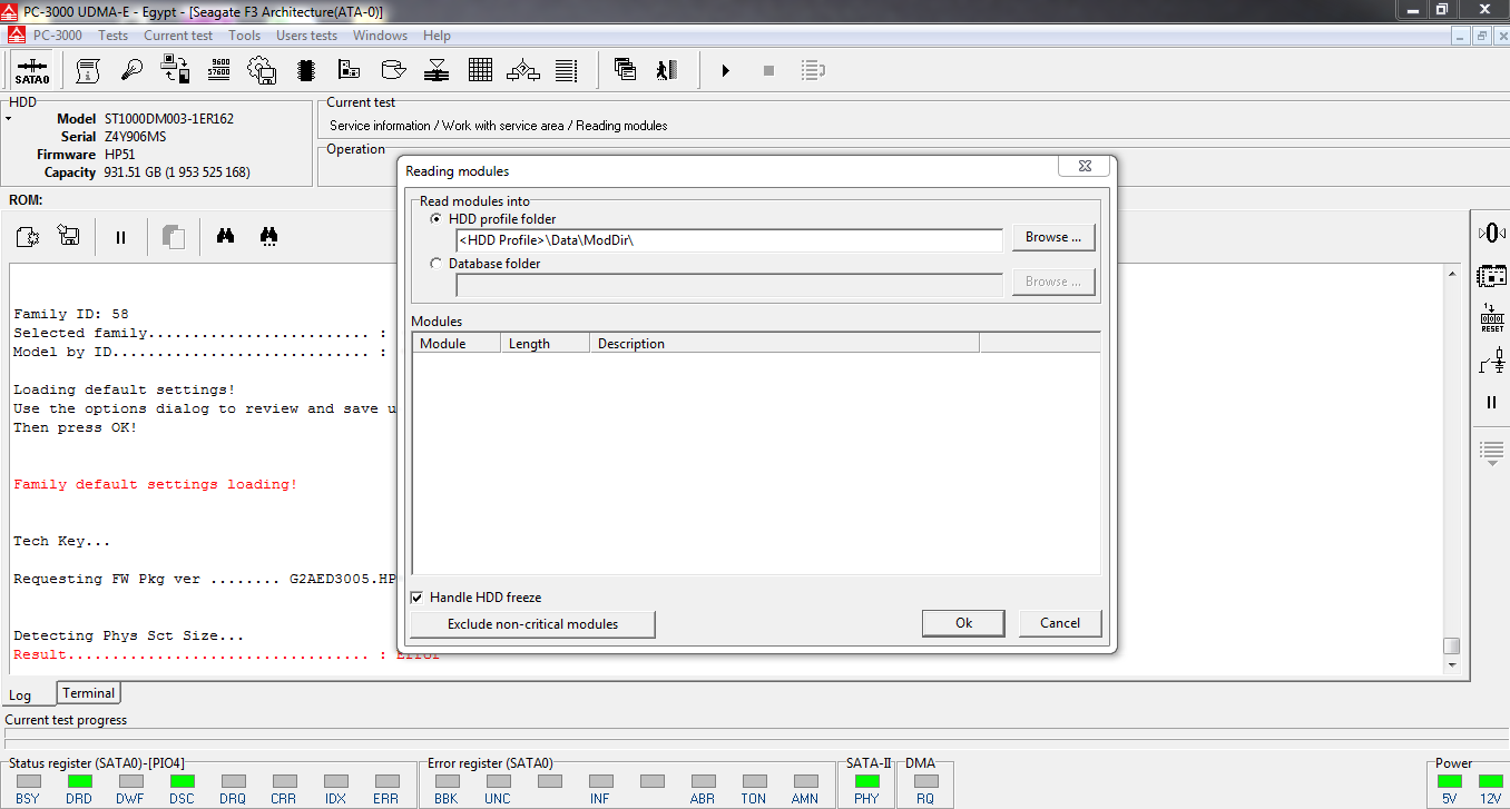

terminal ok
but cant read any rom or modules
i think its locked or something like that
ST1000DM003-1ER162

Re: ST1000DM003-1ER162
Hi Waleed,
Seems Like This is Some HP "Hewlett Packard " Firmware And Not Seagate Once .Ask TS Staff How Can The solve This ,Might Be First Flashing It with Seagate Firmware .But i am Hopeful you Can Read Rom In Boot Short Mode
This is Seagate F3 drive with locket terminal commands.
New version allows to recover data from these drives.
Dmitriy_TS wrote:Source of the post Hello,
That is Good To Know Dimitry Boss
