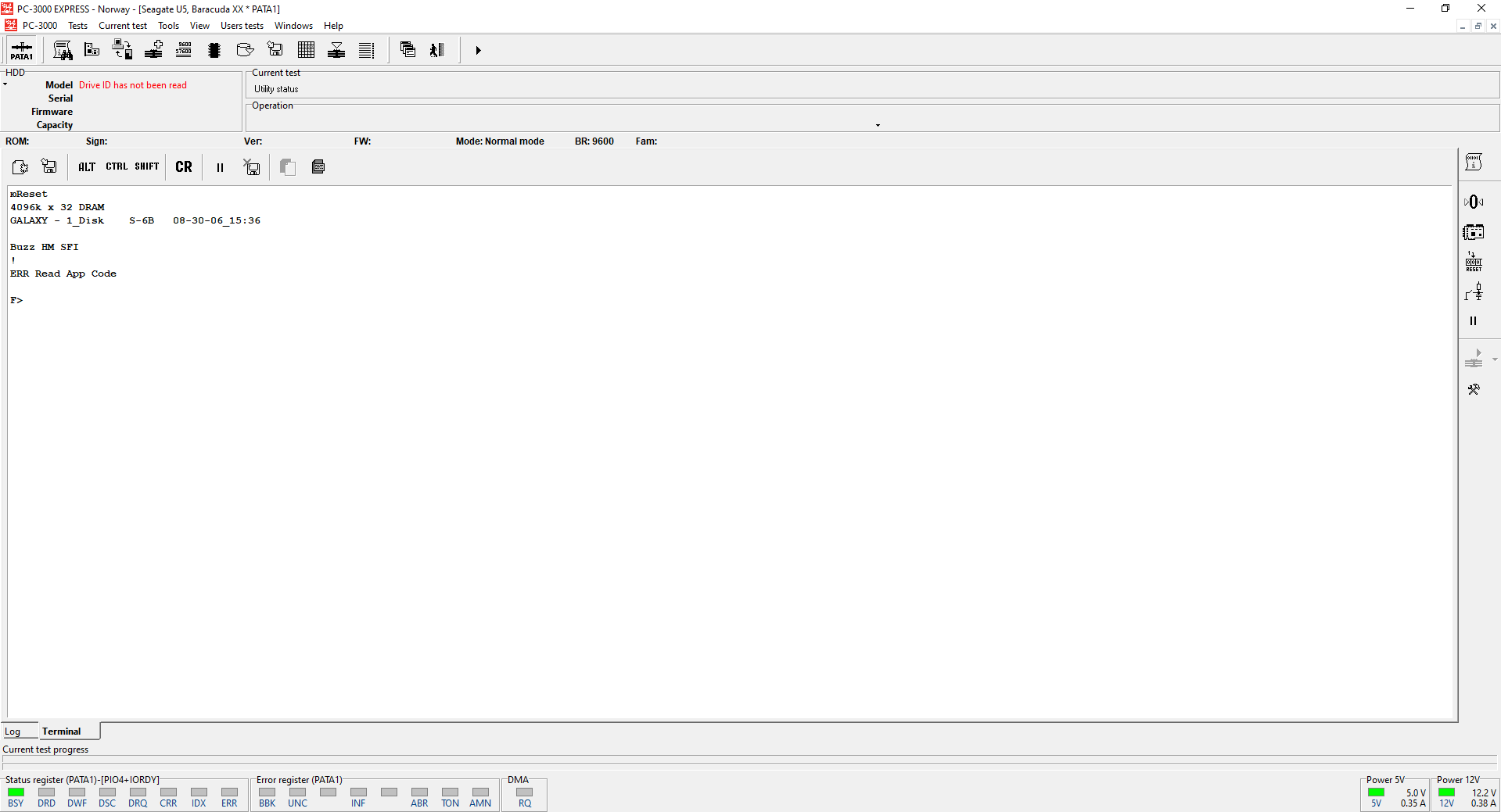

I'm working on this station now.
Did a head change because I thought that was the problem ..
But I get the same result afterwards.
Anyone know what I can do next? (Photos attached)
Re: Seagate st3320620A ERR Read App Code
Postby AJ2008 » 17.02.21, 17:09
either some serious error with SA (F> is never good sign...) or heads are not compatible, or PCB is not original
Postby AJ2008 » 17.02.21, 17:10
can you read app code manually?
