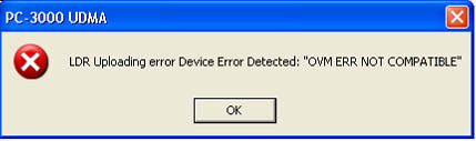

Thank you Roustam, but when load LDR I get:
Any advice? It should work I think...
