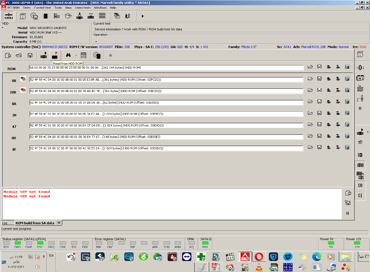

I tried load LDR from original module it hung up at the end of loading and identified XYZ with 0 size, not failed to create ROM from SA . 109 is missing, Error 0D
Guide me please .
without that procedure PC-3000 always gave me 0 size no drive name or SN , but motor still running .
I tried to build ROM from SA, but there is no 109 module.

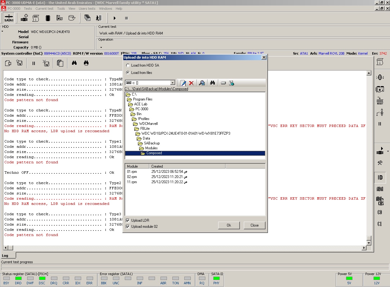

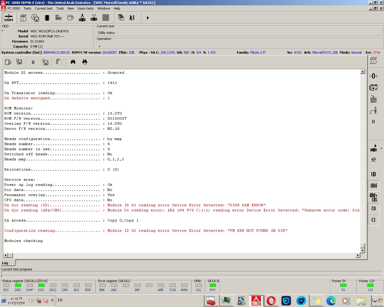

Thank you Mr. Rezafarahm for your respond, I Need same module WD10JPCX-24UE4T0 witch has same ROM Version.
I read damaged HDD modules by Composite reading but the problem is not solved.( XYZ and Zero with 0 size ) after ATA uploading to RAM.
please refer the screen shoots
firmware for WD10JPCX-24UE4T0 FW ver 0016000T.jpg (9.11 KiB) Viewed 21017 times
to identify the problem.
firmware for WD10JPCX-24UE4T0 FW ver 0016000T.jpg (300.71 KiB) Viewed 21017 times
