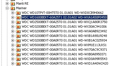

I need loader for WD2500BEKT-75A25T0 - ROM FW Vers is 0014002D
It is from class MARINER.
Thank you.

You are sure this is mariner? It could be from Europa or Saturn family, I never see A25T in MAriner before.

Yes i'm sure, i have three donnors 00A25T0 but not the right loader.

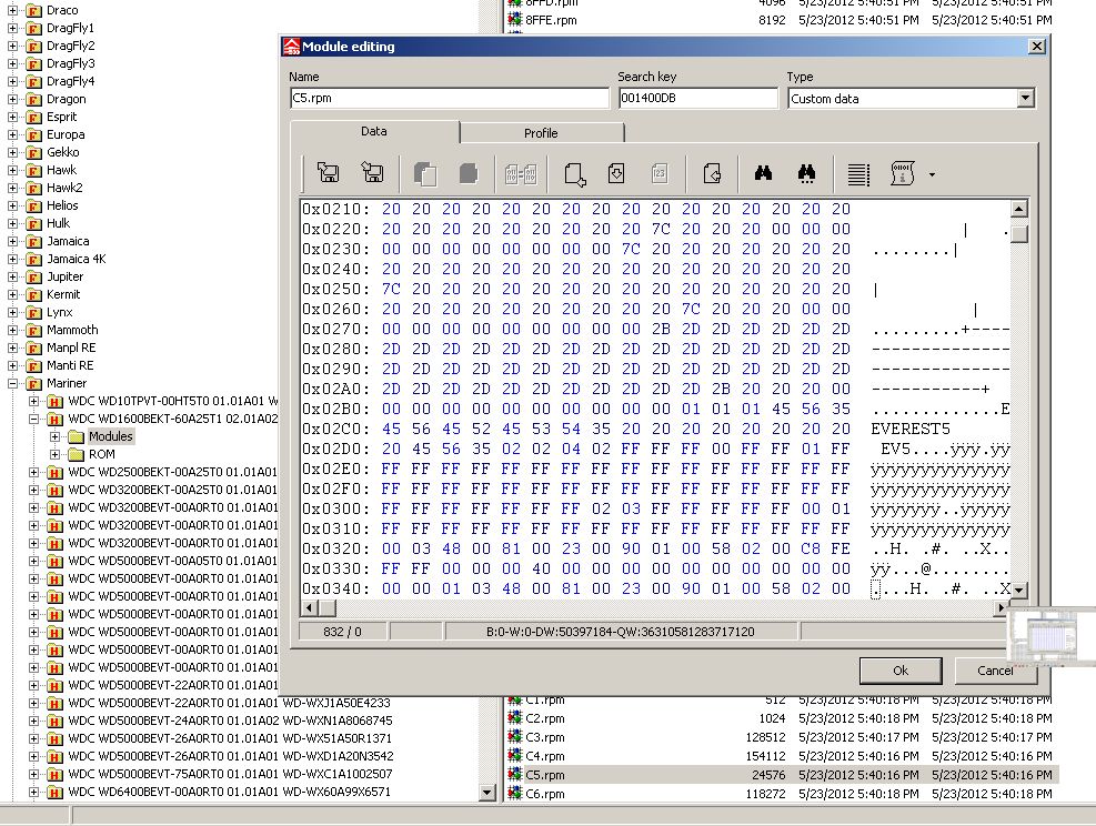

Can you check module #C5 from the A25T in your database? I am sure this model should be Everest5 or Europa series.

You have right in C5 the class is EVEREST but in utility AUTODETECT goes to MARINER
