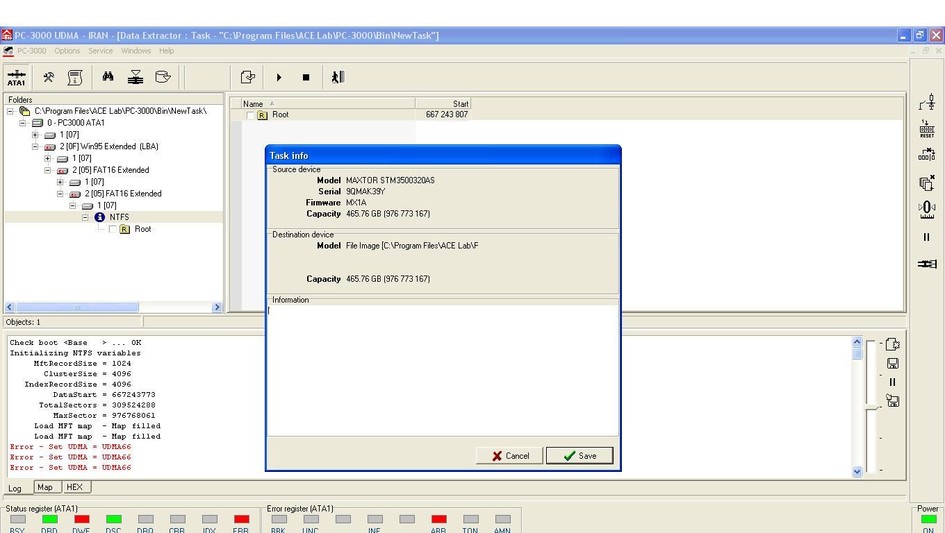

I have a HDD Maxtor STM3500320AS (500G SATA), that it recognizes as Well(Maxtor STM3500320AS)in Bios and Device manager
but the partitions doesn't appear in My Computer, I connected it to PC3000 UDMA,now I want to recover the data, but i don't know how! I'm beginner, please see the screen of DE in the fallowing:

Postby AJ2008 » 12.06.12, 17:14
You need to disable any pending operations via "HDD ID Edit" option in utility.
Other option is to set "power off/on" on error because (i believe) pending defects cause HDD to loose ready.

Postby kamyabi.h » 13.06.12, 08:55
I got it 'OFF' and again turn it 'ON' but when i want to do any operation (for example view sub directory of partitions) the error "Error - Set UDMA = UDMA66" occurred and DWF and ABR register lights red.

Postby AJ2008 » 13.06.12, 10:24
OK then you need to remove all pending related options within utility. This should help.

Postby kamyabi.h » 13.06.12, 16:14
Ok, But How can I work with utility to fix this problem? :-(
I have another one of this model of HDD(STM3500320AS) that knocking sound and program can't recognize it, you know how can i Recover it? or some other HDD that knoking sound?

Postby AJ2008 » 13.06.12, 17:22
For knocking HDD you need to first diagnose it properley.
For pending option, I already stated it is under "HDD ID" options within utility.
