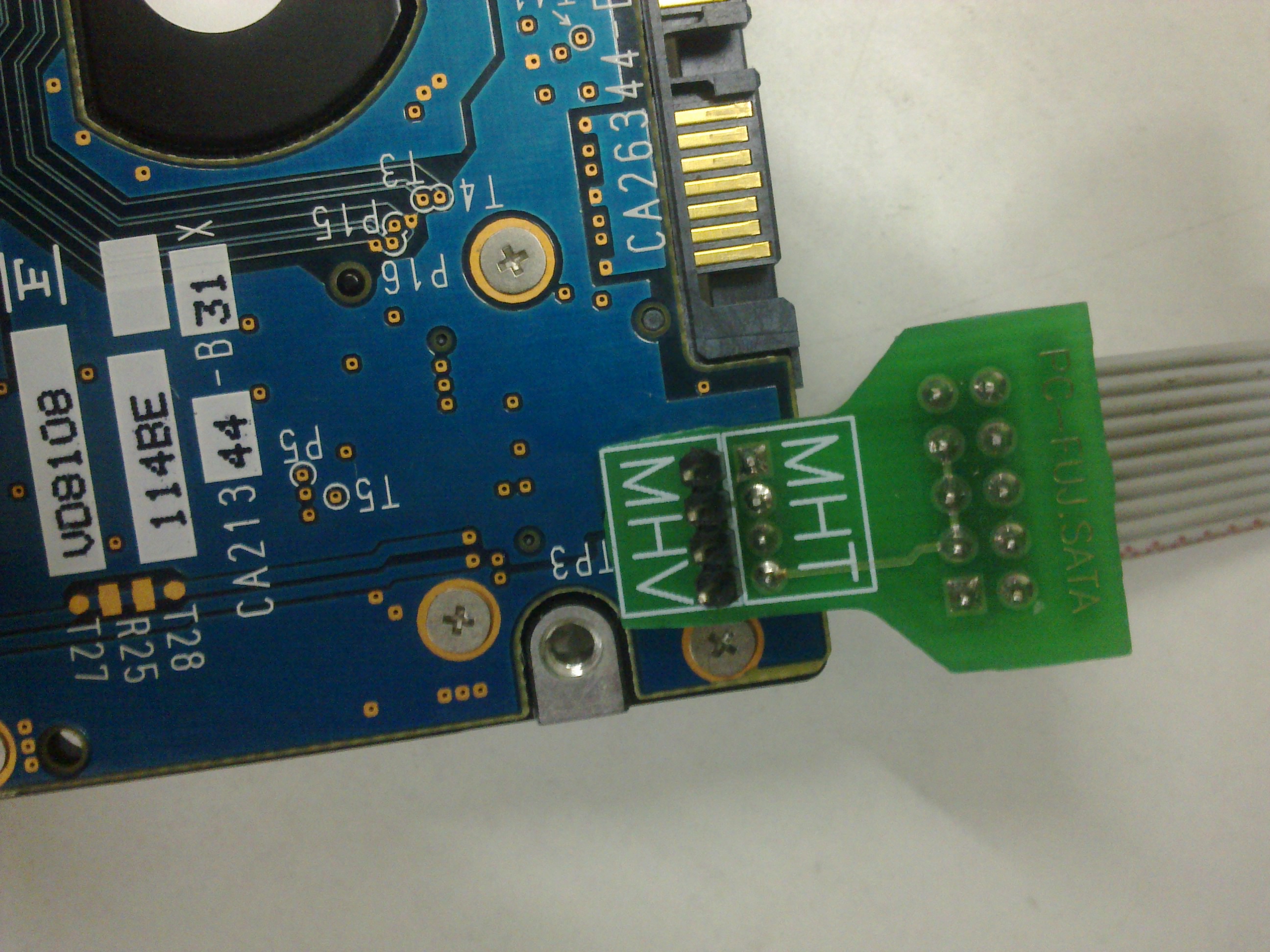

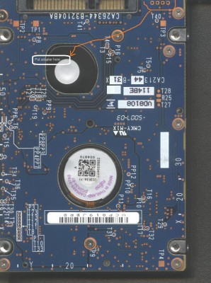

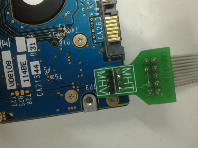

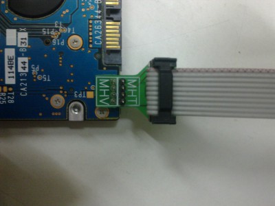

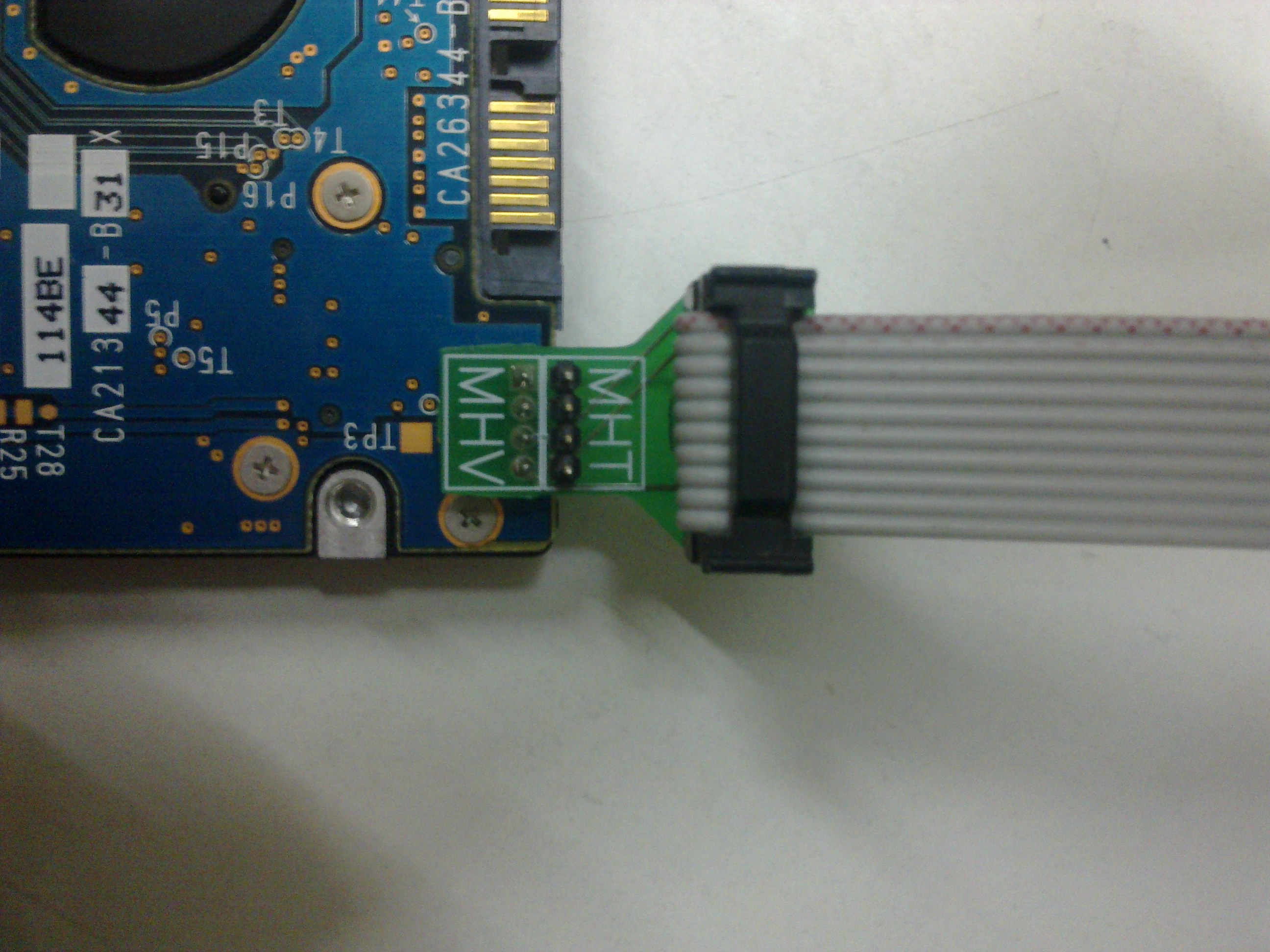

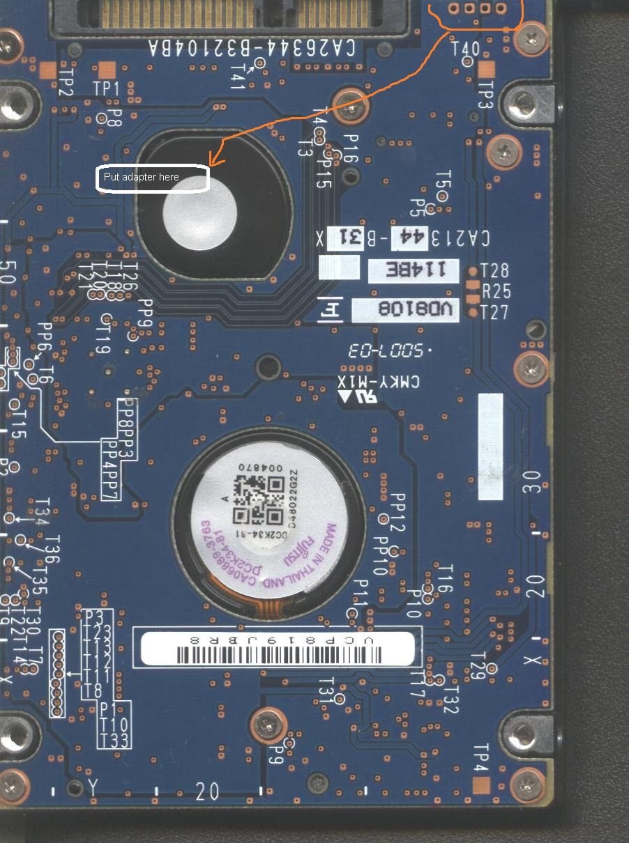

Postby hassan » 10.03.11, 19:25
To unlock fujitsu use fujitsu MHV / MHT adopter
at right of data (sata) on the pcb you can find 4 holes put the MHV / MHT adopter in this holes and start the unlock procedure

Postby hassan » 14.03.11, 06:31
Dear Moji
I am sorry now i don't have fujitsu MHW to try unlock but try
1-mht adapter
2-mhv adapter
