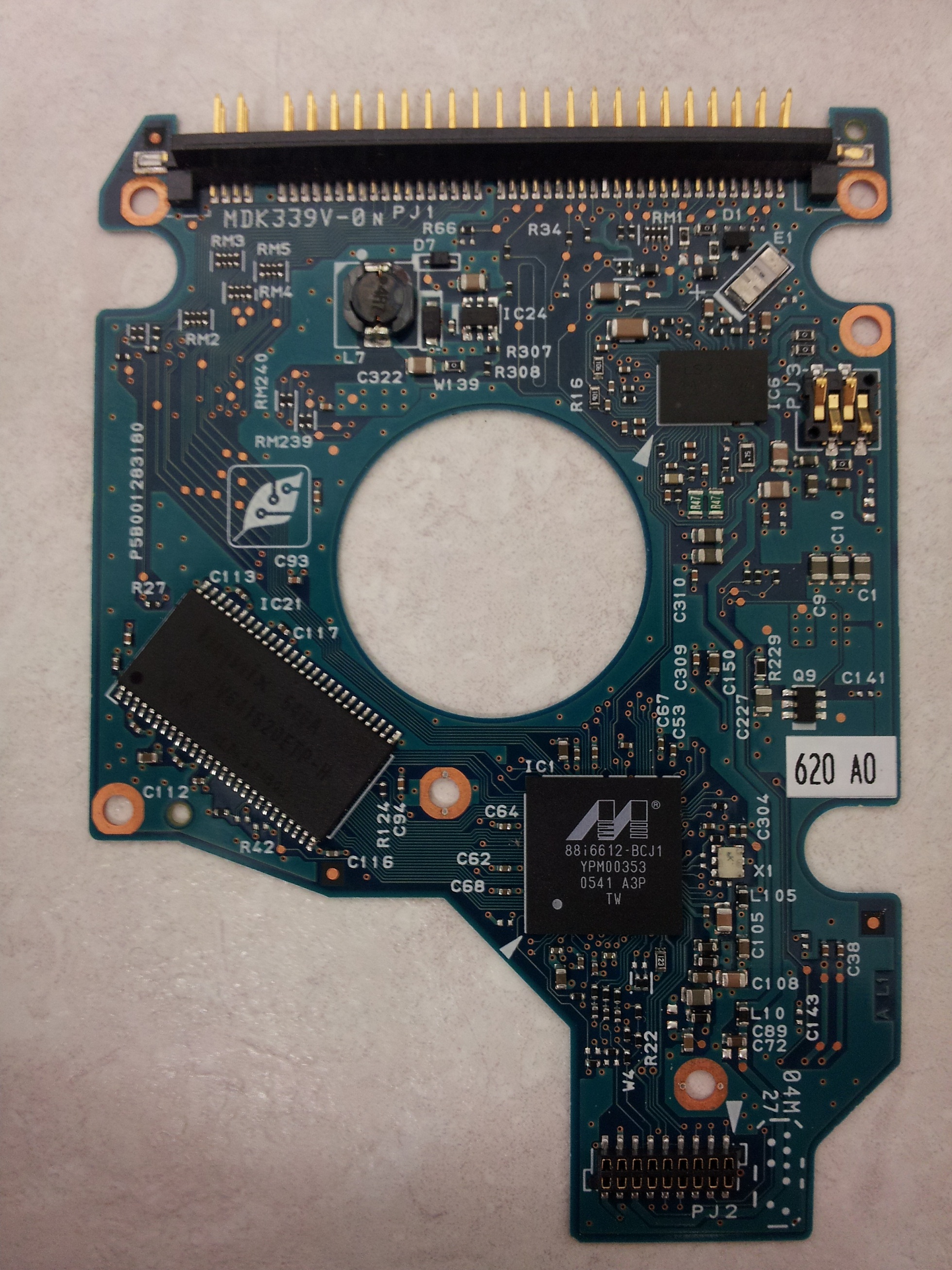

I have been trying to diagnose this PCB as I am aware simply swapping it will not work. I cannot see any ROM chips so am struggling with it a little, can anyone advise any tests? I have a very similar drive so have been comparing the results of various component tests, sadly I have found no differences so far...
Patient:
MK1031GAS
HDD2A02 F ZK01 S
Possible Donor:
Mk1031GAS
HDD2A02 S ZK01 T
Patient PCB
Re: Power issues on MK1031GAS
Postby ACE_Admin » 12.12.12, 17:29
On Toshiba drives , ROM chip is an 8 leg chip and has IC602 text closely.
On this board, the ROM is internal, inside the CPU chip(one with "M" logo). The only method I can suggest is unsoldering
whole CPU chip from original drive PCB and installing it to good working patient drive board.
