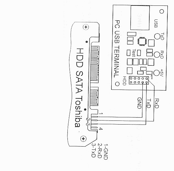

We're missing the Toshiba serial port connector for a 2.5" SATA drive. Does anyone have the pinout of GND, TX and RX on the HD, so I can connect it manually?

This one is for sata.

Thanks!
