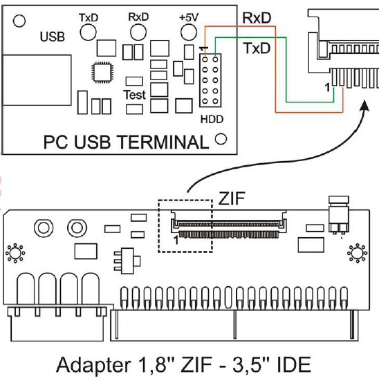

Way to connect terminal to 1.8 Toshiba drives
Postby ACE_Admin » 29.04.10, 17:23
Manual way. But it is only one we have at this moment.
mvg
Posts: 16
Joined: 08.07.07
Re: Way to connect terminal to 1.8 Toshiba drives
Postby mvg » 17.08.11, 09:13
Hi Igor,
This picture is not visible. Could you re post?
Mathew
Postby ACE_Admin » 09.04.12, 09:09
Here it is.
