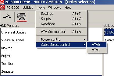

Dear CarlosAdolfo,
This can happen because Toshiba drives require Cable-select mode turned on.
Please, choose in Cable Select control menu ATA0 channel or ATA1 channel ( depends where HDD is connected )
Regards.
Regards.
