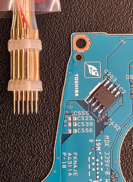

Been reading and writing Toshiba ROMs on the PCB for years with pogo WSON clip with RevelProg IS, very fast and safe.

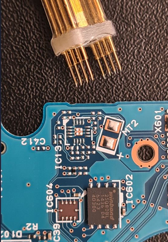

There are a lot of working pogo pin adapters for both WSON and SOIC chips.
Agree that moving chip is 2 min job, but i prefer to read and write :)
