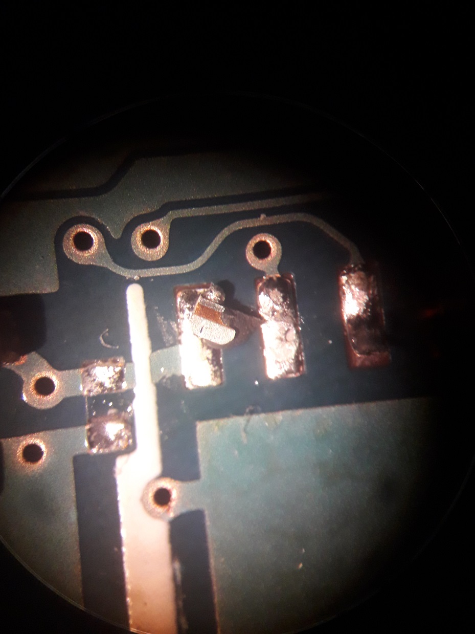

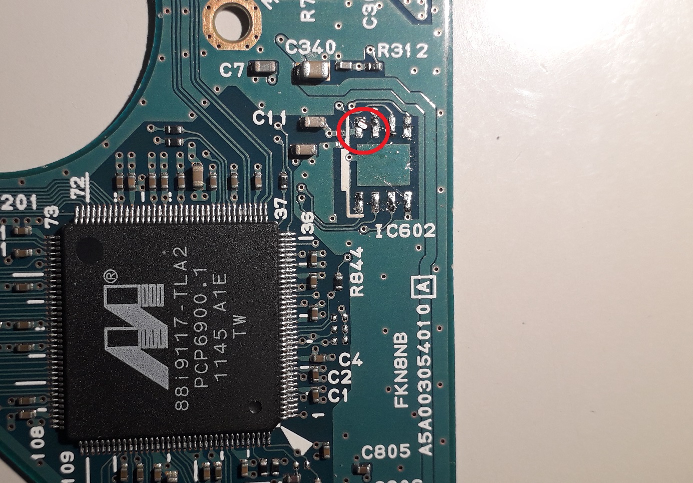

As a result (of his joyful creativity) he broke pin no. 8 (line Vcc 2.5V - power supply of ROM).
This guy didn't even notice it.
The broken pin (with a piece of chip) remained on the nativ USB PCB - see photo's below:
He just soldered the ROM chip to the sata board and ..... the disk is dead.
Then it ended up in my DR company.
I put the ROM chip under the microscope.
Unfortunately - I didn't see any path, no thread, no microjoints - just a rough and crumbled chip fragment.

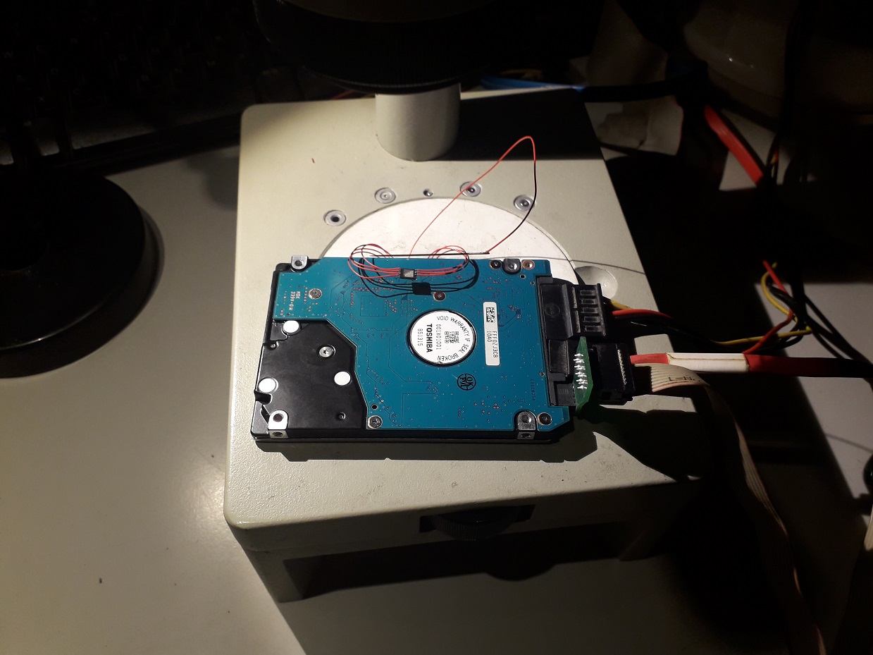

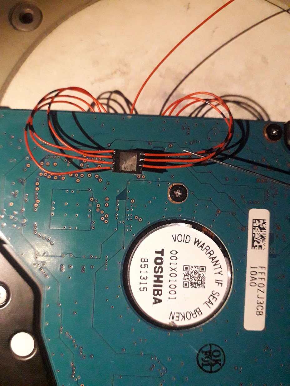

I decided to do similar to the cards or microSD (spider).
I connected the ROM chip to the outside of the SATA PCB so as to have open access to the ROM pins (during HDD works).
There are no very high frequencies or high amperage here - so it can be done with short wires.
Seven wires were soldered to undamaged pins.
And the eighth (on a longer cable) was soldered to the smal sharp needle.
I put everything under the microscope and connected to the PC3K.
Then, I very gently insert the point of needle (looking under the microscope) and more to press in various places of the damaged pin hole (crater) and turn on the power on the PC3K whenever.
After a few attempts - pounded needle point she had to touched the ROM power line and the HDD started ! :D
I quickly launched Toshiba utils and downloaded the ROM.
Then .... it's just that a piece of cake.
100% data recovered - happily, in this case only native PCB USB were damaged.
