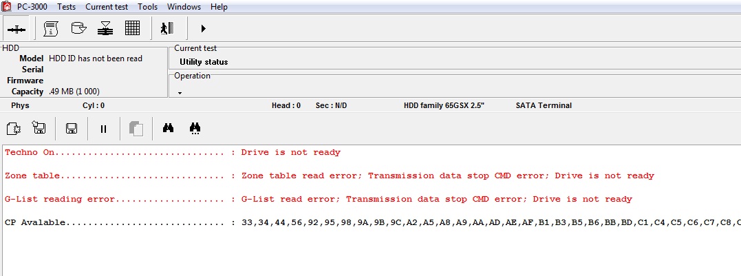

i am getting this (Attached)error in pc3000 portable ,
Unable to read HDD ID,BSY,DRD and DSC glows,
I also have donor PCB. What might be issue?
Thanks to all gurus in advance

Please check and see if terminal adapter is connected to that drive when you were entering the utility.
One, with "PC-Toshiba " text on it, must be used with this drive.

yes it is connected
