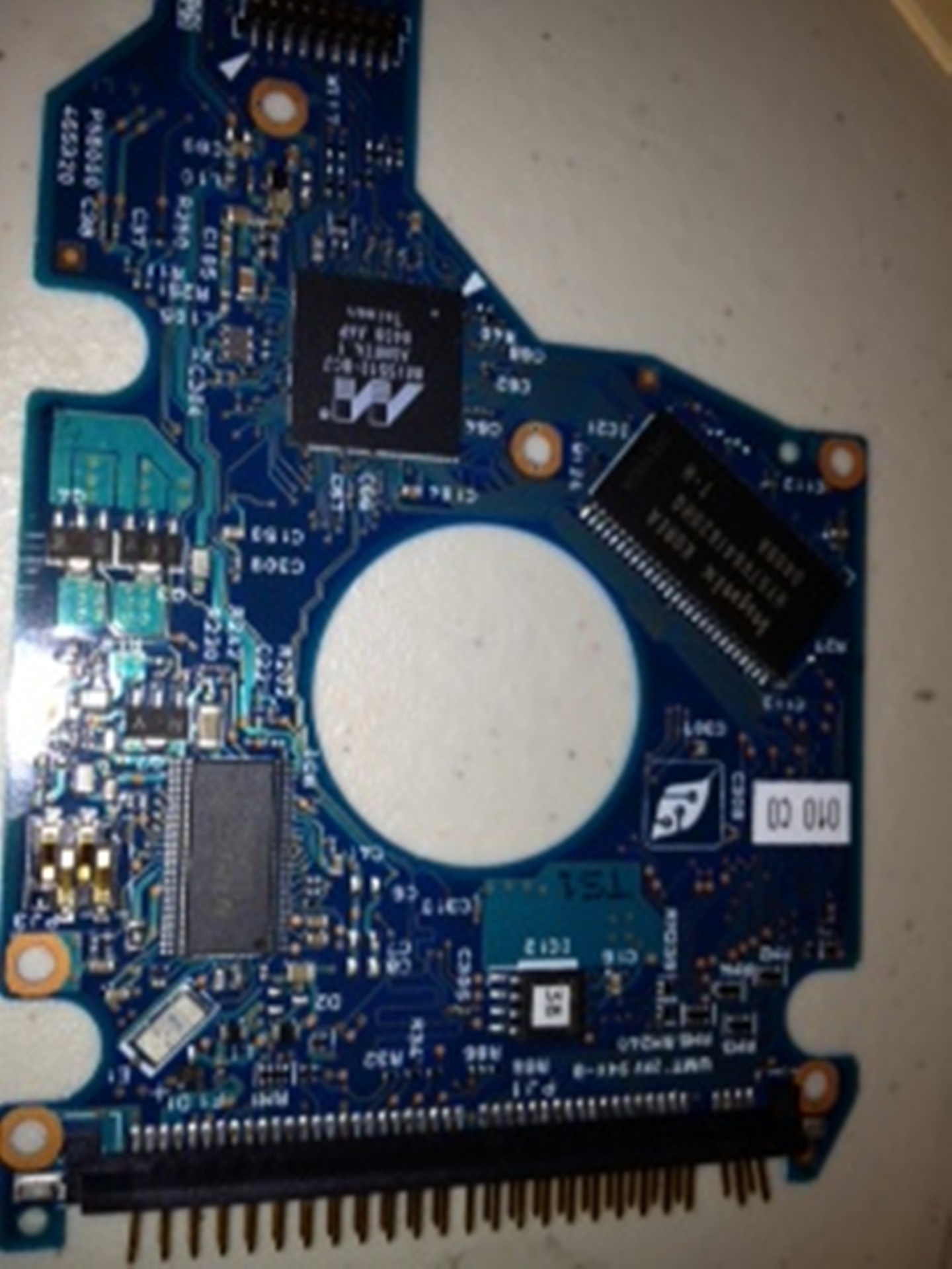

So I have another Toshiba laptop drive with a burnt board. Do I need to move the ROM chip on this?
toshiba board- blue full view.jpg (34.5 KiB) Viewed 3304 times

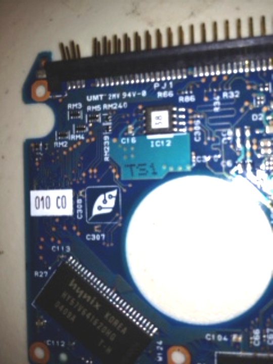

Is the ROM on this 8 legged chip?
toshiba board- blue closeup.jpg (29.97 KiB) Viewed 3304 times
Re: TOSHIBA LAPTOP ROM CHIP?
Postby ACE_Admin » 16.03.12, 09:38
If you will check Toshiba drive photos you will find that usually ROM chip is marked as IC602. It has 8 legs and rectangle shape.
