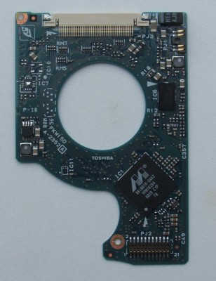

I have one MK1231GAL with PCB problems, i need to swap PCB.
For this class the ROM is included in the main CHIP?
Thanks.

It is most probably that ROM locates in main chip within this family.
For make sure you can post here good picture of pcb and we will decide.

I attached a photo of the PCB
MK1231GAL - PCB.jpg (32.19 KiB) Viewed 4225 times

Unfortunately ROM locates in main chip.
