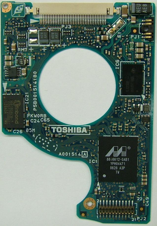

Dears,
I need to know where it is in the PCB the ROM of this model MK6008GAH..
The PC3K-UDMA, supports this model MK6008GAH?

Dear Alexandre Silveira
We will support this family soon.
By the way you could post a photo of this PCB over here.

Re: About ROM of MK6008GAH
Postby Alberto » 20.02.09, 14:47
Looks like no External ROM,like another toshiba models and UDMA doesn support it until now to read CP´s from Donnor PCB should be unsoldered the complete BGA Mp to the Donnor PCB, im know complex task

Postby AJ2008 » 23.02.09, 10:15
What is the 8 leg chip to the left of the PCB, above the Winbond Chip?
Postby Alberto » 24.02.09, 05:27
i cant did a zoom at u picture, but could be usefull check information on that 8 pins ic, maybe its Serial ROM, but , u need to check "letters" over the ic, u can use Google to find if its ROM or another integrated
Postby steven » 25.03.09, 11:03
I think its ROM must be embedded in Marcell MCU

Postby AJ2008 » 27.03.09, 15:22
I also think ROM is embedded into processor.
