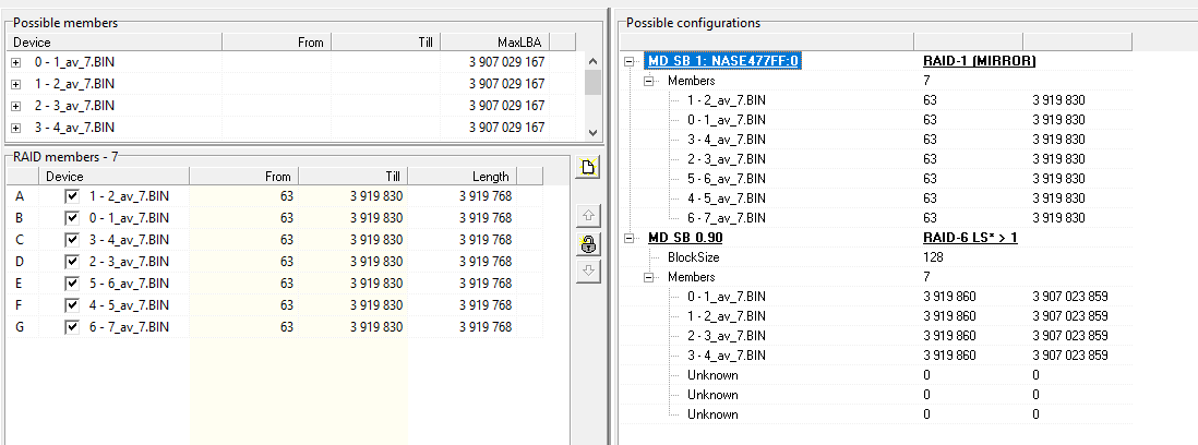

- NAS Problem: Customer lost access to control panel (the person who set up the NAS 5 years ago couldn't remember), and they performed a factory reset, They got access, but could only find the data originally copied to the NAS 5 years ago. Not any newer data.
- Unused drives.. Yes, but they are not empty. When I imaged the drives, the first four drives had approc 2 TB data, the latter 3 drives had 300 GB
- Correct mix.. The drives are numbered, and I used same order when adding drives to raid in PC-3000. Autodetect discovers two possible configurations. See image:

What's file system on the raid? What are PC-3000 and DE versions?

Posted: 21.05.20, 13:55
by lcoughey
After getting all the drives cloned, I would take 5 minutes to look at the mdadm details on each drive to determine the RAID config and order of failure. Once determined, then I'd take another minute or two to load the RAID with UFS Explorer and it should be smooth sailing after that. Of course, if there is some odd file system, LUNs or encryption, things will be slowed down while figuring them out.
