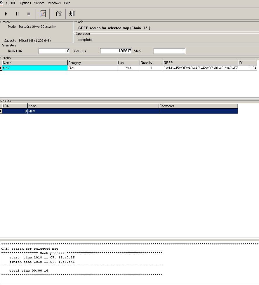

Now I couldn't find good file on his drive, I'm trying to creat the reference from another MKV file. As the solution shows in blog. I attached a picture the result of my grep search for mkv.. As solution shows It looks good.
Here is the grep created by DE:
\xA3\xA3\x42\x86\x81\x01\x42\xF7\x81\x01\x42\xF2\x81\x04\x42\xF3\x81\x08\x42\x82\x88
Maybe this is OK..
Maybe this is OK..

It's look like the problem was solved with a new task.. I don't know the restore why doesn't work for references but now it find some mkv.
