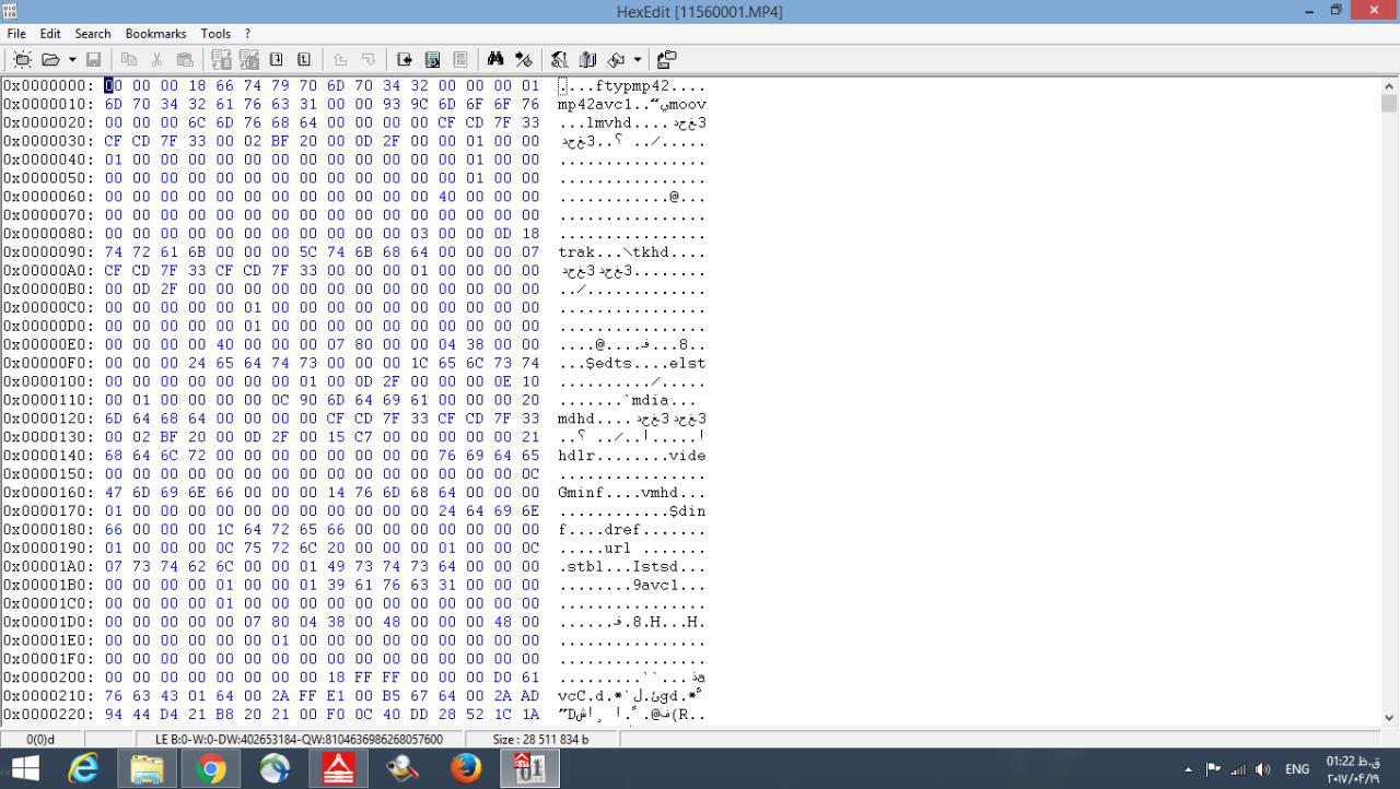

hi
this is file simillar
tnx

thanks for post
but no work soultion
this is file mp4 fream 50/s
