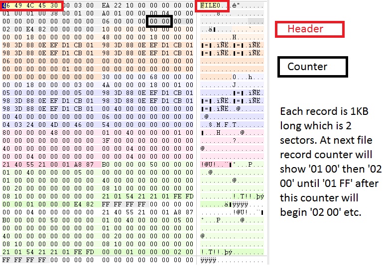

I work on many RAID systems. for NTFS there is simple process that works in cases of RAID 0 in file counters. There is sequence to follow that will help construct manually.
NTFS File Record counter.jpg (276.38 KiB) Viewed 5231 times
Hope this helps 8)
