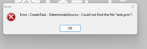

I've got a full hDD image (raw image) that i've created a couple of years ago with rapidspar. And i was wondering how I could open it in DE.
I tried to create a new project, setting the source folder for the img and for destination I've set up a VHDX file but DE keep showing an error when it asks to select the img file (img000000.bin):
Error: createTask - DeterminateSource - could Not find the file "task.prm"!
any suggestions?

Hi Slim,
Create a new task
Select "External file" as source
No need to "Make data copy" ( you already have a copy )
In next window select you RAW image bin file and you are ready to go.
If your source raw image is split you can merge them to one file https://blog.acelab.eu.com/pc-3000-data ... -file.html

Thank you for the info. It did work.
