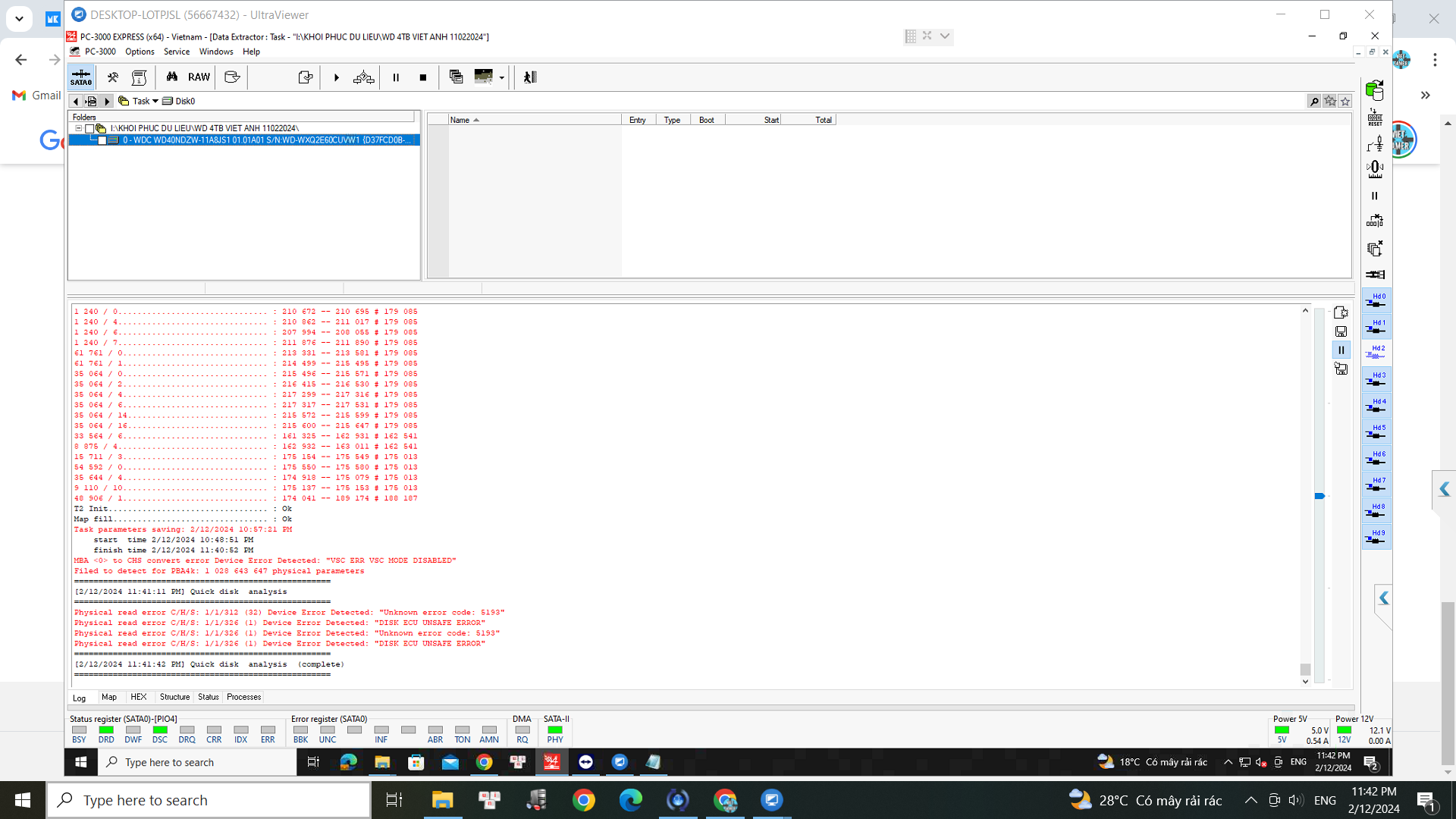

HERE IS CODE WHEN BUILDING HEADS MAP
Reading method.......................... : VSC command (T2 Data read)
T2 read................................. : Ok
Zone type............................... : Type 2
Zones................................... : 5 865
SMR zone read........................... : Ok
SMR zone indexing....................... : Ok
26 329 / 9.............................. : 193 030 -- 195 885 # 173 119
26 329 / 10............................. : 196 121 -- 196 983 # 173 119
2 296 / 4............................... : 197 227 -- 203 049 # 173 119
2 296 / 12.............................. : 203 050 -- 208 570 # 173 119
38 749 / 5.............................. : 208 571 -- 214 399 # 173 119
41 036 / 4.............................. : 206 153 -- 206 860 # 176 129
58 306 / 4.............................. : 206 861 -- 207 364 # 176 129
58 306 / 7.............................. : 207 365 -- 207 857 # 176 129
......................STILL MORE AFTER THIS................
MBA <0> to CHS convert error Device Error Detected: "VSC ERR VSC MODE DISABLED"

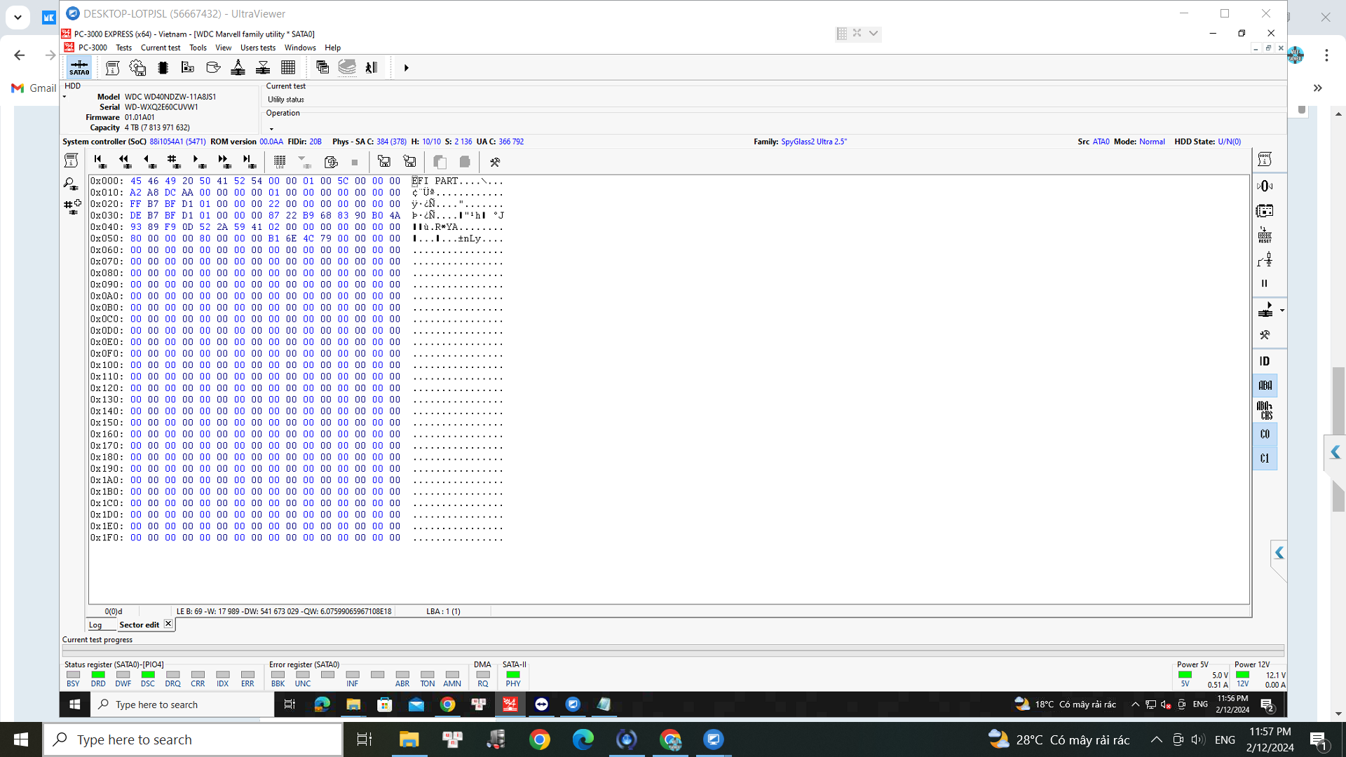

Sector Edit before Decryption
Screenshot (626).png (430.66 KiB) Viewed 5743 times

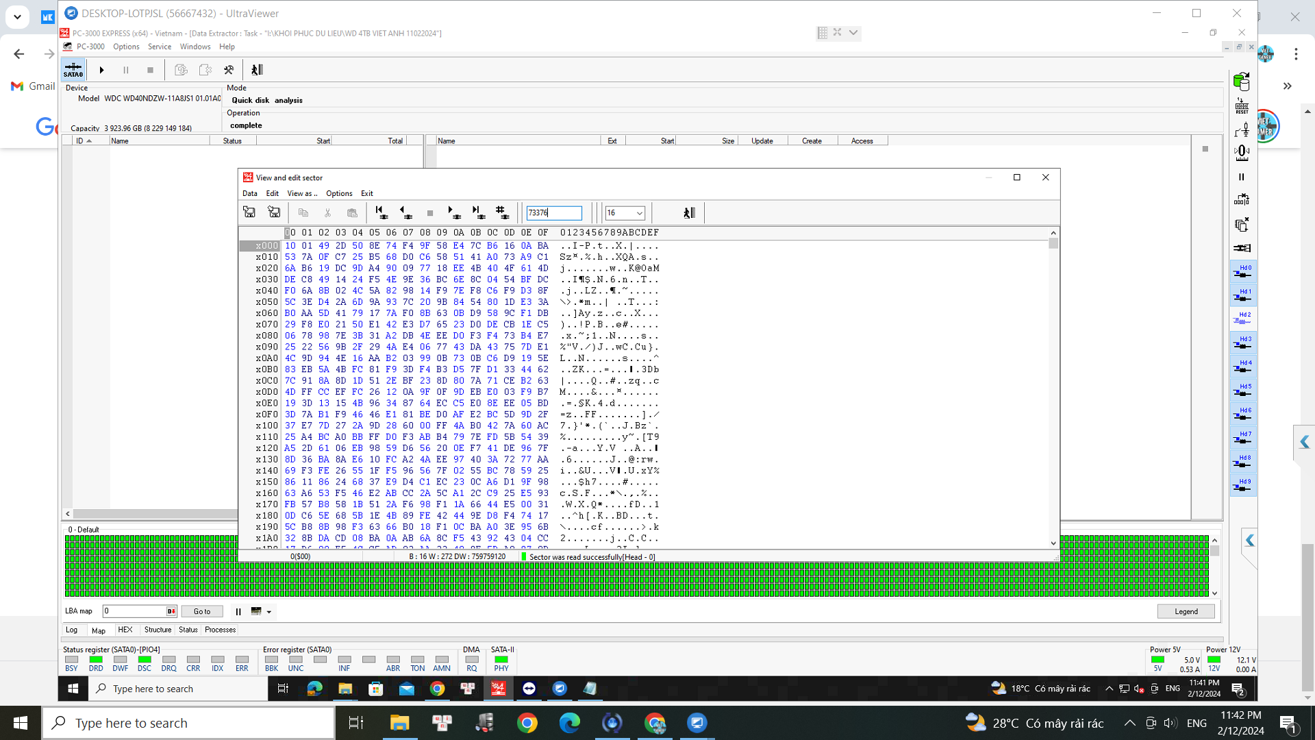

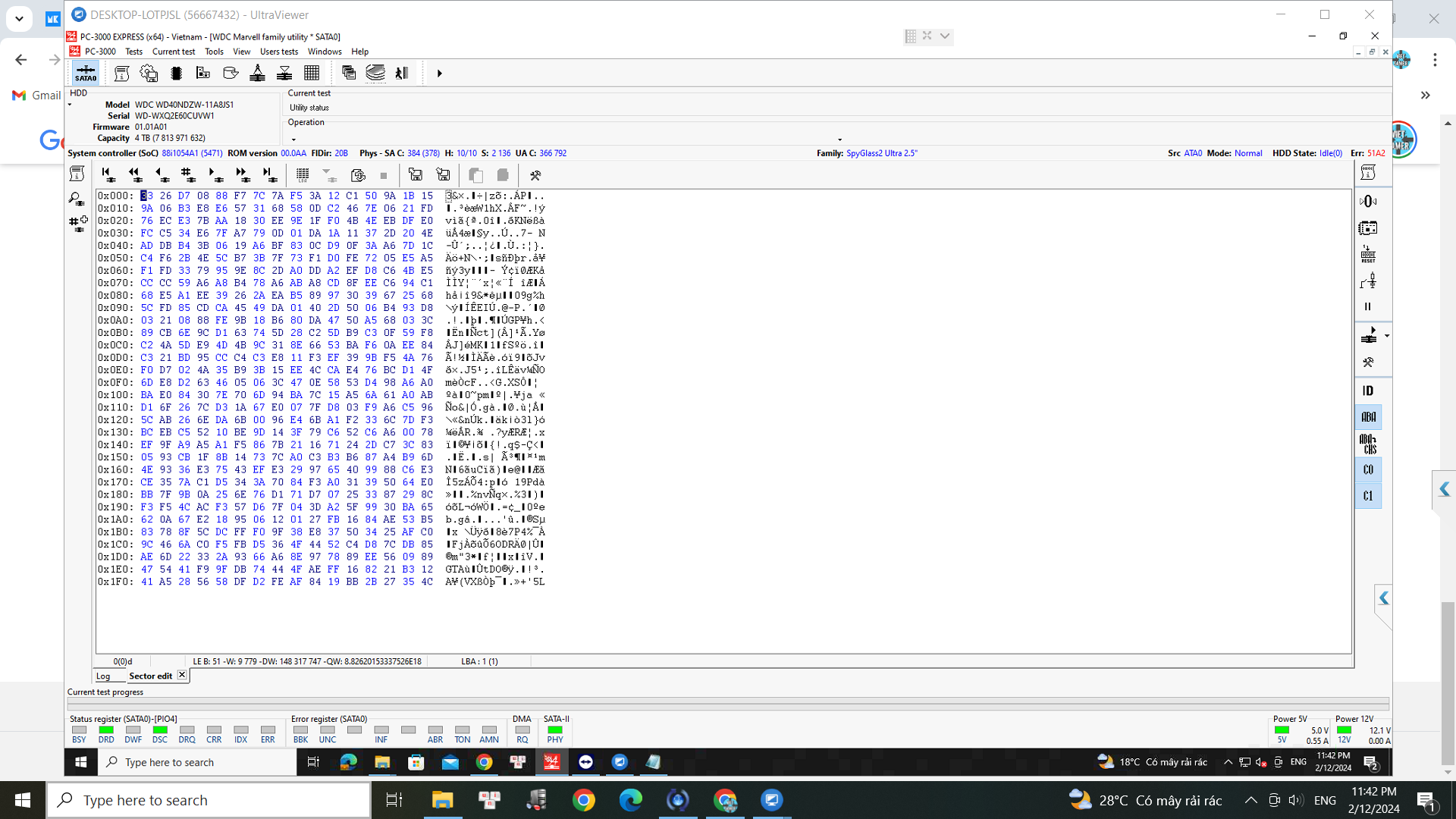

Sector Edit after Decryption
Screenshot (625).png (513.44 KiB) Viewed 5743 times

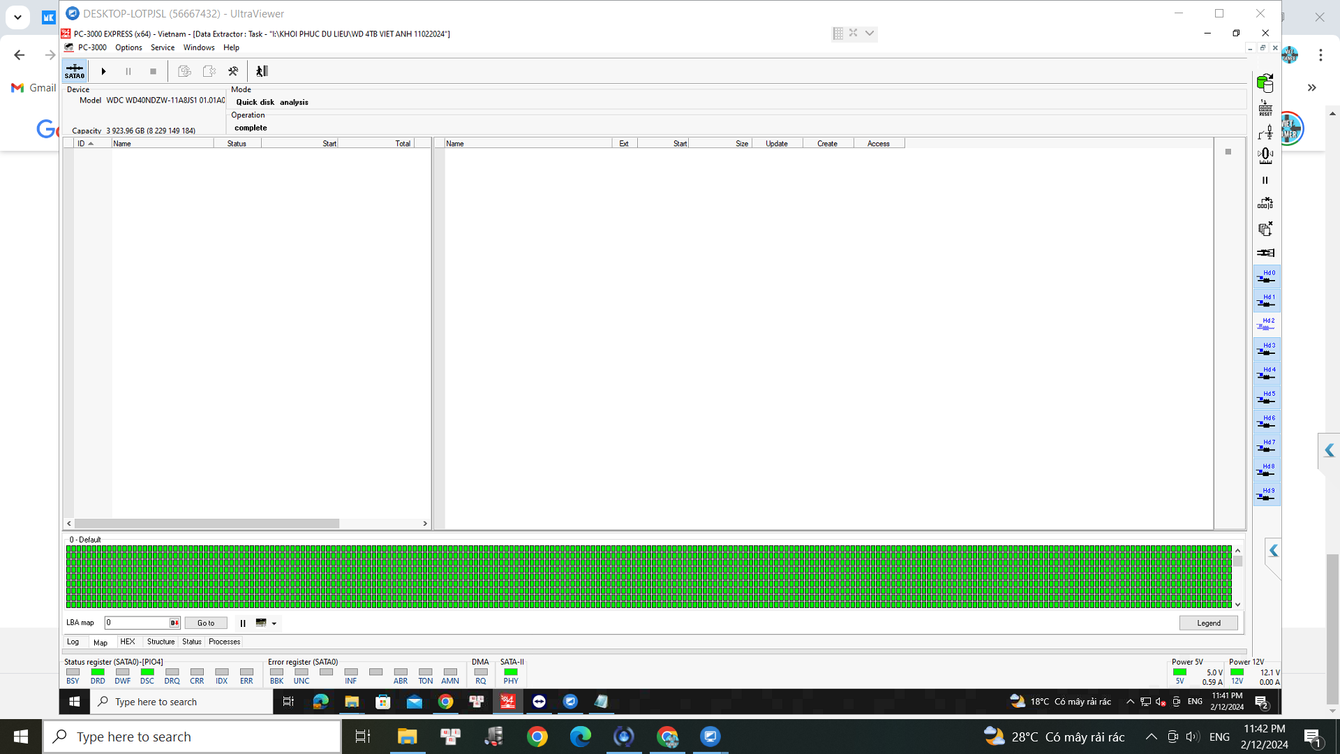

Data in DE
Screenshot (622).png (375.53 KiB) Viewed 5743 times
Data by sector in DE
Screenshot (623).png (554.51 KiB) Viewed 5743 times
Head Map
Screenshot (624).png (423.08 KiB) Viewed 5743 times

In your pic "Sector Edit before Decryption" data is not encrypted.

Data decryption is done through the original MCU.
It sounds like you are applying unnecessary decryption through DE.

digitalsupport wrote:Source of the post In your pic "Sector Edit before Decryption" data is not encrypted.
Even without decryption. With sector edit you can see the Data, Same in sectors in DE, however the data doesn't want to show up
