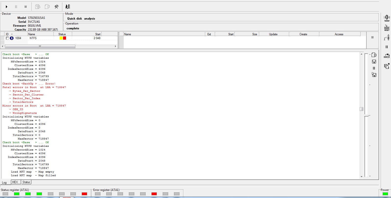

hi,
I am facing LBA error followed by ABR error while performing the Quick Disk Analysis (snapshot attached). I don't understand what to do with it. I am also unable to open the dis drives which gives "Root Dir is not valid operation aborted" error. Kindly help in recovering the data.

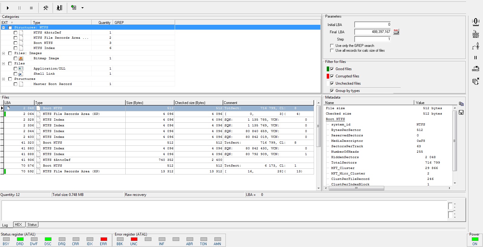

There is one partition missing. The one that you show is not your main partition.
Run raw recovery on your drive and show results here.

northwind wrote:Source of the post on your drive and show results here.
The Raw Recovery results snapshot is attached herewith

If you look at your first picture posted, look at the status registers. You have issues with this drive. I suspect its bad heads. Can you post the terminal readout.
Re: Seagate momentus 5400.6 LBA & ABR Error
Postby digitalsupport » 06.06.20, 13:29
+1, drive has problems that needs to be taken care of before imaging.
