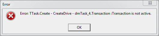

I got this error opening an existing task
Error: TTask.Create - Create Drive - dmTask_4.Transaction :Transaction is not active
It doesn't change restart the utility or downgrade to a lower version.
Source drive is a USB WD
What the message mean?
Thank you all
Spark
Posts: 36
Joined: 22.11.10
Reputation: 1 / (12)
Re: DE error opening an existing task
Postby Spark » 16.07.19, 12:20
Problem solved.
Moving (not copy) the task to another disk with total commander get "Please remove the write protection!"
On source disk there isn't in explorer the "CUT" option so I just copied it (not moved) to another disk
Now task opens regularly and i'm doing research on the problem related with this unit.

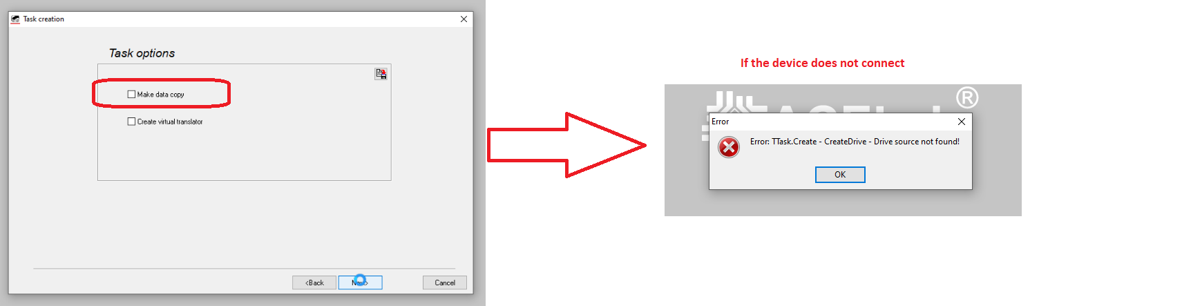

adrianf25
Posts: 3
Joined: 17.02.15
Postby adrianf25 » 14.05.24, 02:09
The problem is how the task was created without saving sectors and then it was not connected.
Error TTask.Create - CreateDrive - Drive source not found.png (32.17 KiB) Viewed 25280 times
