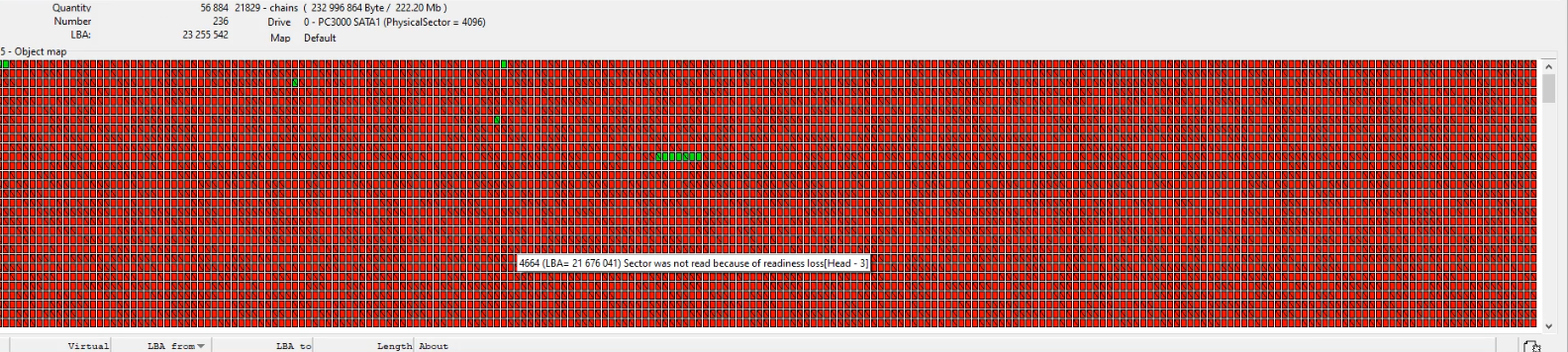

I am reading as many sectors as I can from a Rosewood and have now only yellow and red blocks.
By increasing the timeouts (PIO mode) and the number of retries the red blocks are read manually (i.e. lba by lba) but not by selecting the chains of these blocks.
It is obvious that I cannot manually read the 428MB sectors one by one.
I cannot understand why I have this problem.
Thanks for any help

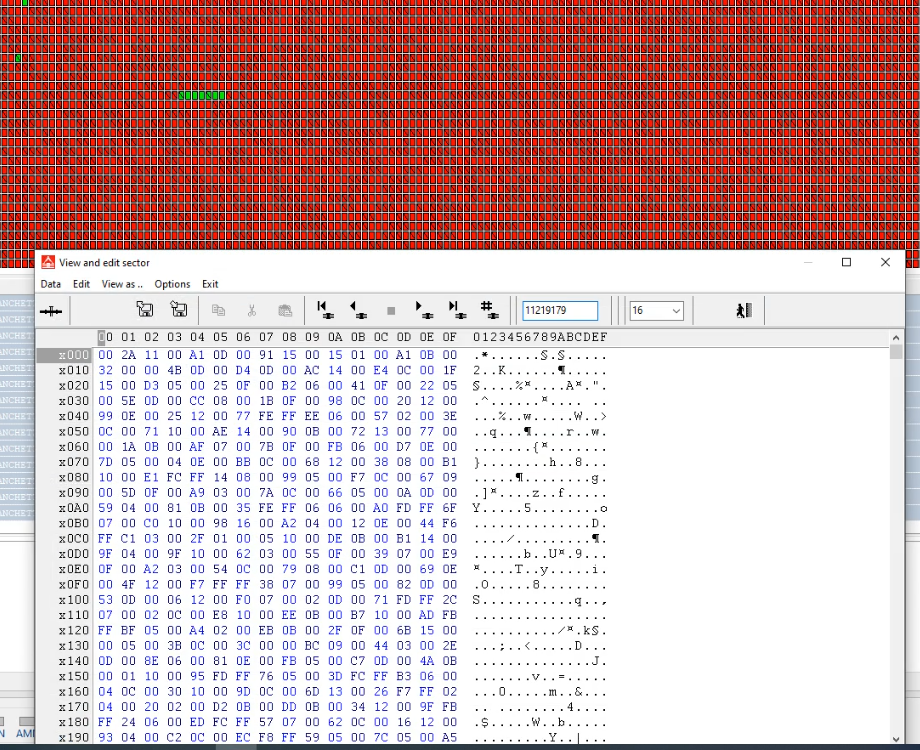

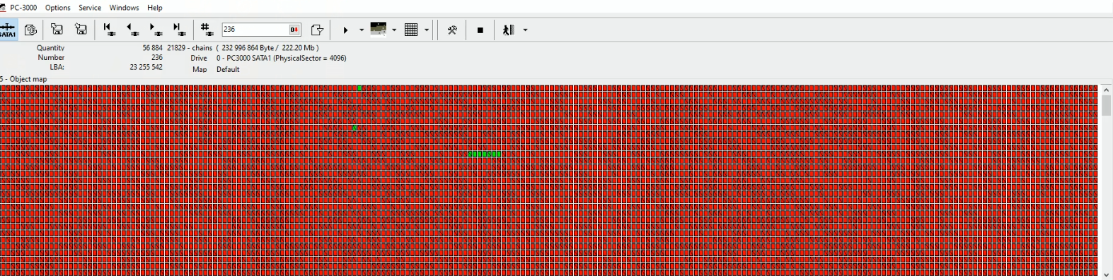

I select the map with the red blocks. I go to read them manually one by one and it reads them.
If I select all chains it refuses to read them. I have attached some screenshots.

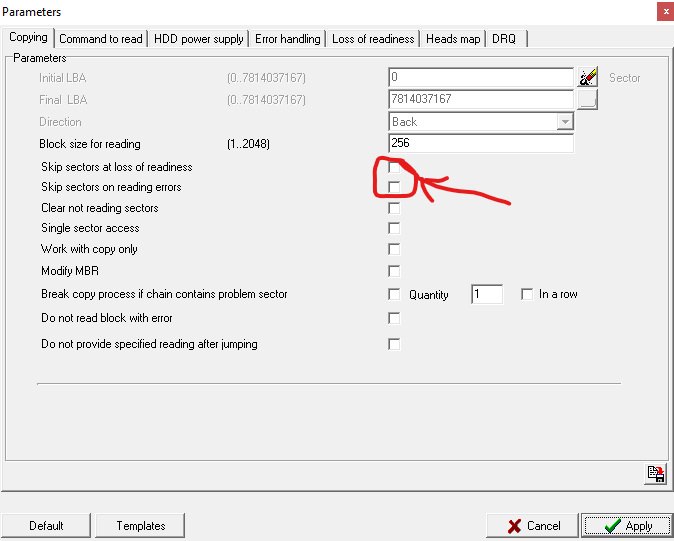

I see this post is old but i have a question? did you enable Skip sectors at loss of readiness? if yes take them of....
Screenshot 2022-11-07 202628.png (17.13 KiB) Viewed 91828 times

Yes. i did imag the drive with Skip sectors at loss of readiness active and got a lot of Skip sectors at loss of readiness.... then when it was finish reading i turn it of and reread and now it read most of those sectors...

Yes I removed that flag.
