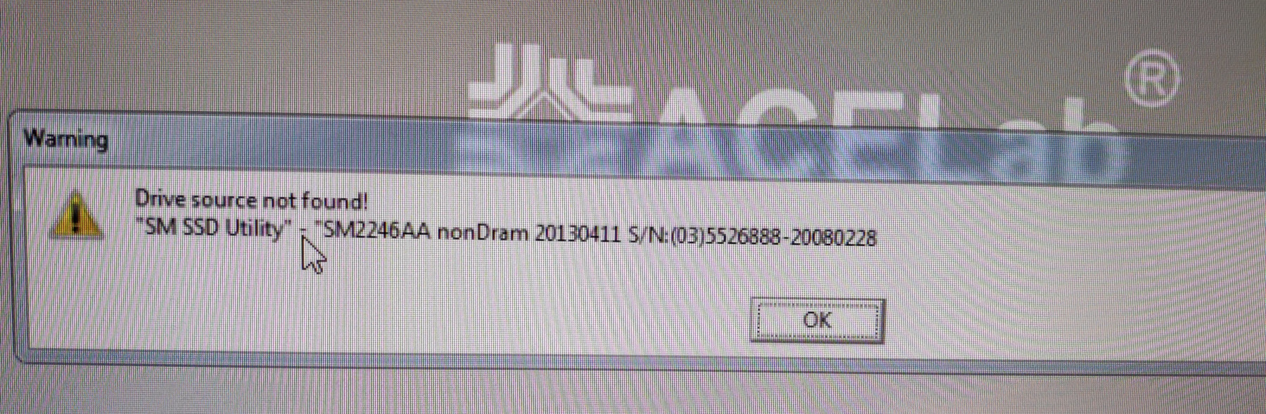

I have a situation here, when I was imaging a SSD. In this case I had to put it into safe mode, load a loader, create a translator and start an Imaging task.
During the Imaging, the system crashed and I had to reboot the PC.
After that, and re-doing all the steps to access data, when I want to resume the imaging process I get an error that I attach.
If I create a new task, I can see that the ID of the SSD is exactly the same. If I copy all files from one task to another except task.prm, I can see the sector map (green and black sectors), but on the task statistics all sectors are marked as not read.
If I copy the task.prm I get the same error.
I don't want to re-do all the scan (it took a few days to do....).
Any suggestions?

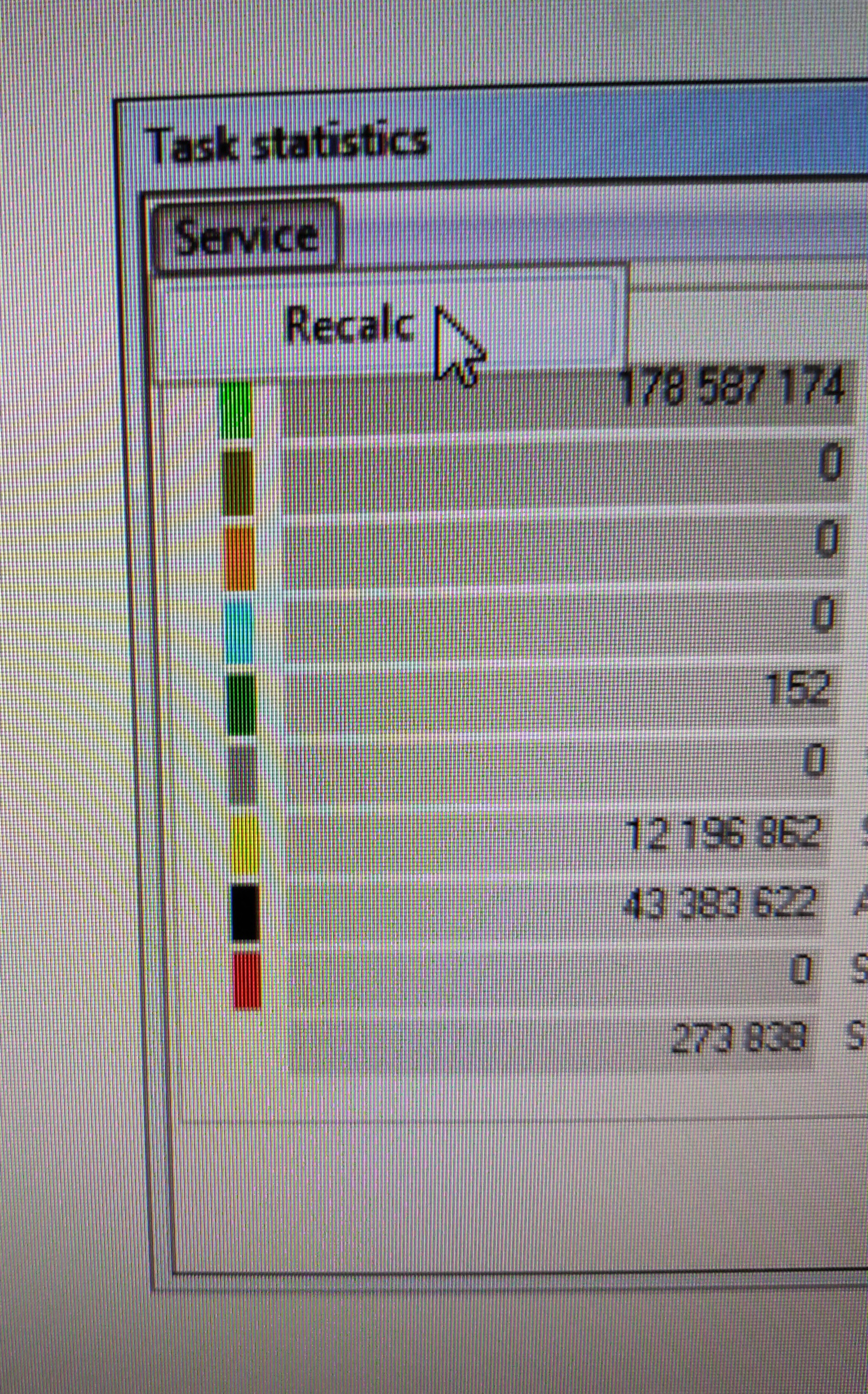

I had this error a while ago. I seem to remember that although the stats map goes blank when copied to a new task, if you build a submap using the legend it does pick up the old stats, it just does not display them.

Found it!!
