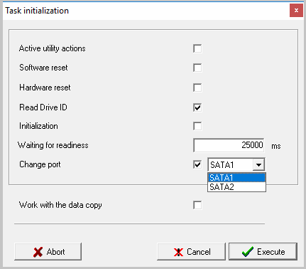

This popup?
But what exactly are you changing here? Source or Destination?
-Espen

Source...You can not change the destination once you've started a task because all info about sectors read , head map ,etc is on that destination....If you change it all that info is lost.
So, to change the destination you must create a new task.

1. you can easily change the destination port (at least when you have the destination connected directly to the system board) when you open the task, as the task will notice that the drive is not connected to the same port and prompt with a list of connected drives...you simply select the same drive on the new port and keep going
