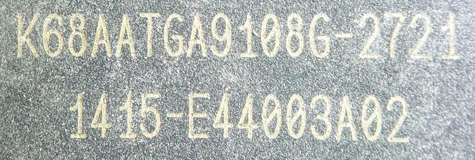

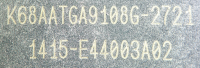

Hello There,
just trying to figure out how to get data sheet or pinout for type of USB monolithic which one not in solobase.
Any advice? Thank you

Re: The best way to get Pinout
Postby Amarbir[CDR-Labs] » 17.03.16, 06:44
You Need a Logic analyser And Then You Have To Find What Pin Does What in Working And Non Working Monolith ,Then Its Possible
Postby slcmlctlc » 17.03.16, 08:10
Thank you, already looking for it. Do you know how many channels will be enough?
Postby Amarbir[CDR-Labs] » 17.03.16, 08:32
slcmlctlc wrote:Source of the post Thank you, already looking for it. Do you know how many channels will be enough?
Hi ,
The TS Guys At Ace Do this all The Time ASk Them And Let Us Know also
Postby slcmlctlc » 18.03.16, 23:27
Now it make sense, since I found Documentation about methodology in my files.
In this document they are using 16 channels Logic Analyzer.
