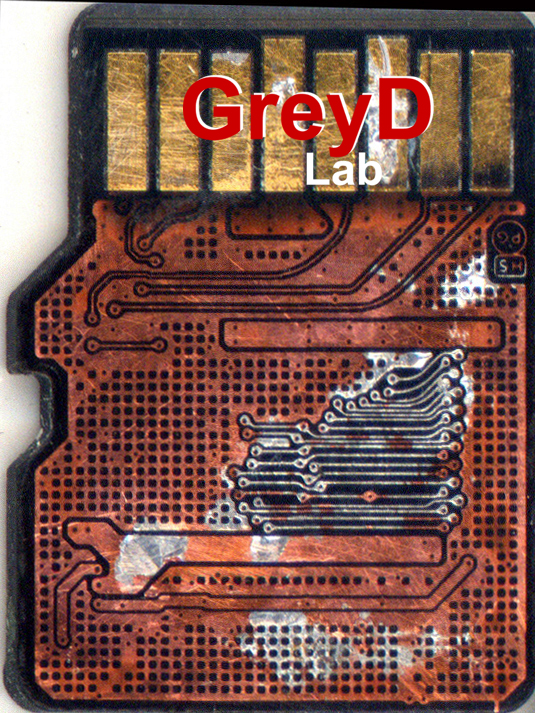

procurement
Posts: 25
Joined: 05.09.18
Re: Transcend microSDHC 16GB monolith pinout and pin description needed
Postby procurement » 17.10.19, 11:10
this is the layout
procurement
Posts: 25
Joined: 05.09.18
Postby procurement » 17.10.19, 11:11
his is the layout

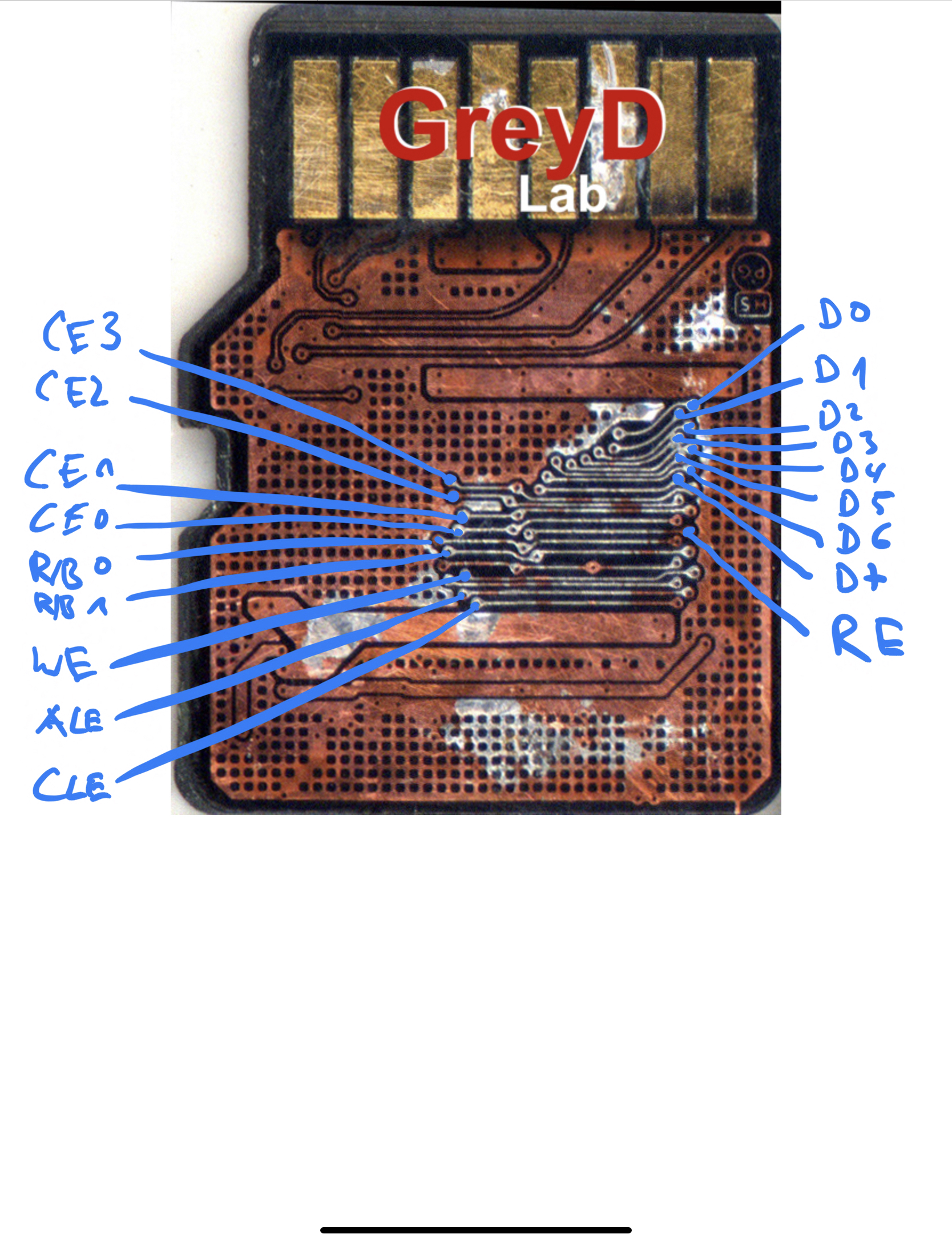

jerema
Posts: 75
Joined: 19.10.16
Reputation: 3 / (26)
Postby jerema » 18.10.19, 09:06
I marked in your picture. Try this, maybee it works.
