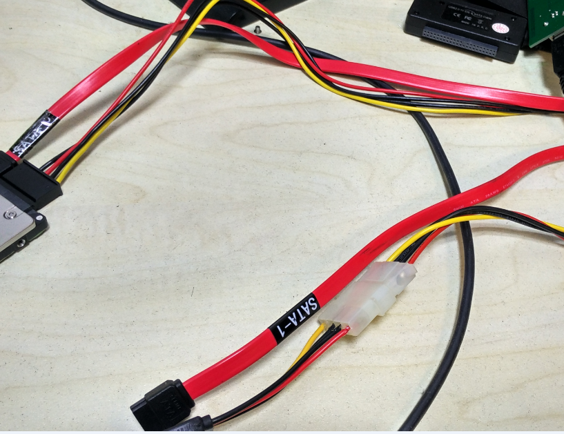

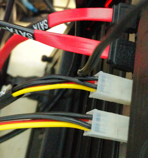

Good day
Scenario
1. SATA 0: running imaging
2. SATA 1: Power on HDD, SATA 0 power off & on, continuously --> same goes to SATA 1
In short, that's no way for us to run both SATA 0 & 1 at the same time (we have not use both at one go once)
We connect all data & power cables as per PC3000 manual.
Do anyone faced the same issue before?
Please advise, thanks in advance.
