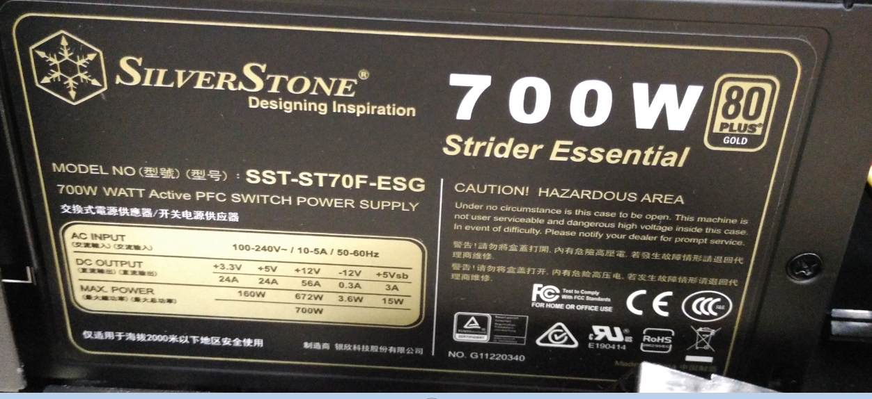

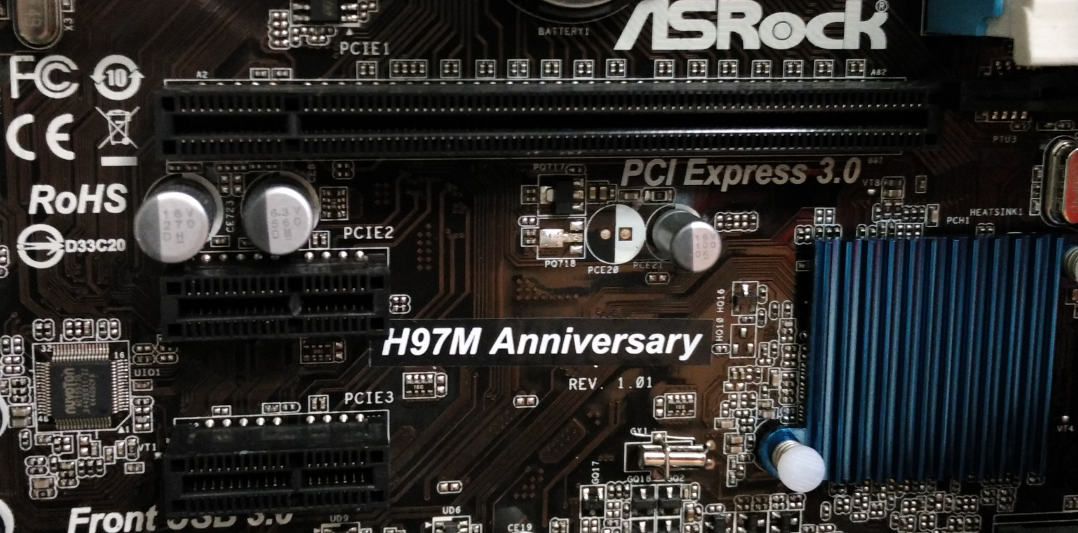

I've received my PC-3000 UDMA a couple of days ago. I've installed the board into one of the PCs here
Motherboard: ASROCK H97M Anniversary
Power Supply: SilverStone 700W Strider Essential

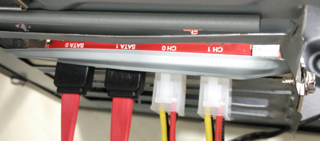

Both Channel & SATA cables connection
I've tried SATA-0 & Channel 0: Don't power on HDD that connected to PC-3000 (Power indicator on the lower right of the program are in red color)
I've tried SATA-1 & Channel 1: Same result
I've switched it to another PC: same result
I've tried to connect SATA 0 from the board to a HDD, power supply from PC - It works, it powered up HDD and everything looks just alright.
Can anyone tell me what is wrong with my setup?

Is your PC-3000 board also connected to the power supply? Can be easily overlooked when installing the board.

Hi JayPiKay,
Yea it is. power supply from PC --> POWER IN

Maybe you have a bad power supply relay board on the PC-3000. I know I had one light on fire early on when I was using PC-3000. Never had an issue since it was replaced.
I'd probably break out a multimeter and check voltages on everything, make sure you've tried different HDD's connected to the channel, etc. to rule everything out before putting in a ticket with Ace.
