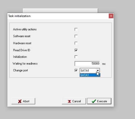

2. Not sure i understand. To move a patient drive with DE task to other PC3000 port / workstation works fine here.
Connect patient to any pc3000 port. Open task, in Task initialization you select "Change port" and select the new port you want to use. If destination drive is also moved to other port, DE will show list of drives where you select the right destination drive again. Used the practice for many years while working with SATA drives as destination drives.

2. You can do that, here:
EDIT: Ha, Allan was faster :)

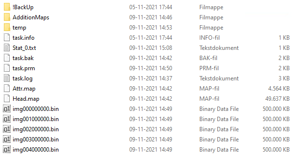

Content of a task folder looks like this
task content.png (21.59 KiB) Viewed 13196 times
Bin files are only there when imaging to bin files.

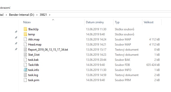

We use imaging port to port on PC3k Express card. For example SATA1 to SATA0.
There are job files on the picture.

Files from task folder should be ok to move, but what to move depends on where the error occurred. Attr.map holds info of read, unread, error sector.
Head.map, explains it self. Task.fdb holds result of partition analysis and any work you did on data incl. found partitions, fs check, virtuals an so on.
If a task failed, i would first try to use backup. If opening backup fails, create a new task, selecting patient and destination again. Close task in DE. Copy Attr.map from failed. Open new task in DE and check it´s working.
Then add Head.map and additionMaps, RAW maps if pressent and needed.
