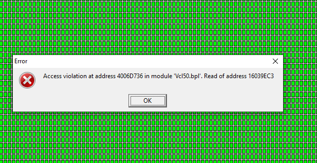

Oh dam, it actually ran for a while then popped out this error : Access violation at address 4006D736 in module 'Vcl50.bpl'. Read of address 16039EC3
Access violation at address 4006D736 in module 'Vcl50.bpl' Read of address Error
PC3000 memory Error.PNG (28.27 KiB) Viewed 10928 times

I sometimes get these random errors. Usually just closing the PC-3000 software and reopening it solves the issue.
