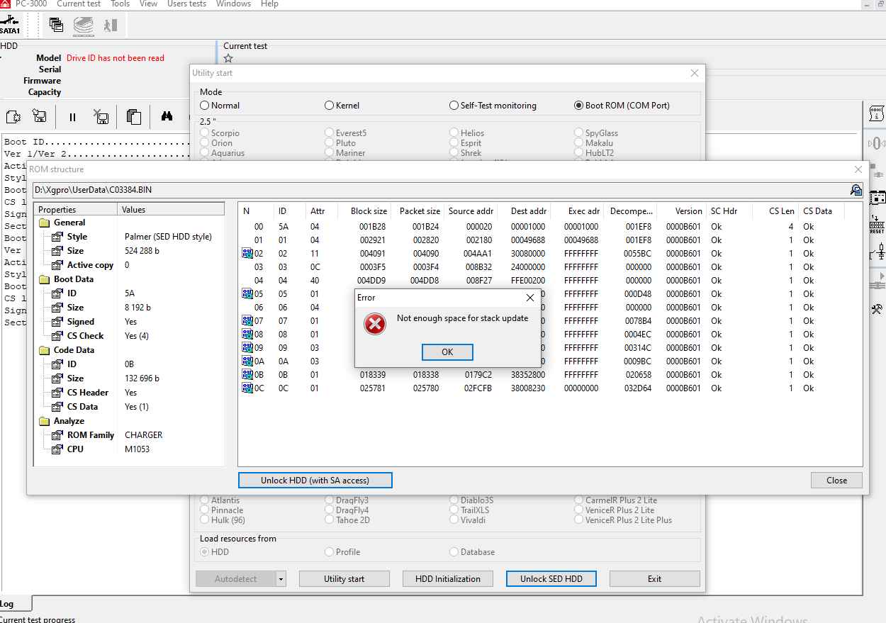

i have an SED locked WD20SPZX-22UA7T0. Read the ROM and unlocked but i'm not able to save the unlocked ROM. What do you suggest?
Unlock error.PNG (88.47 KiB) Viewed 1580 times

Are you sure you have disk space?

It was a ROM copy mismatch on Xgpro

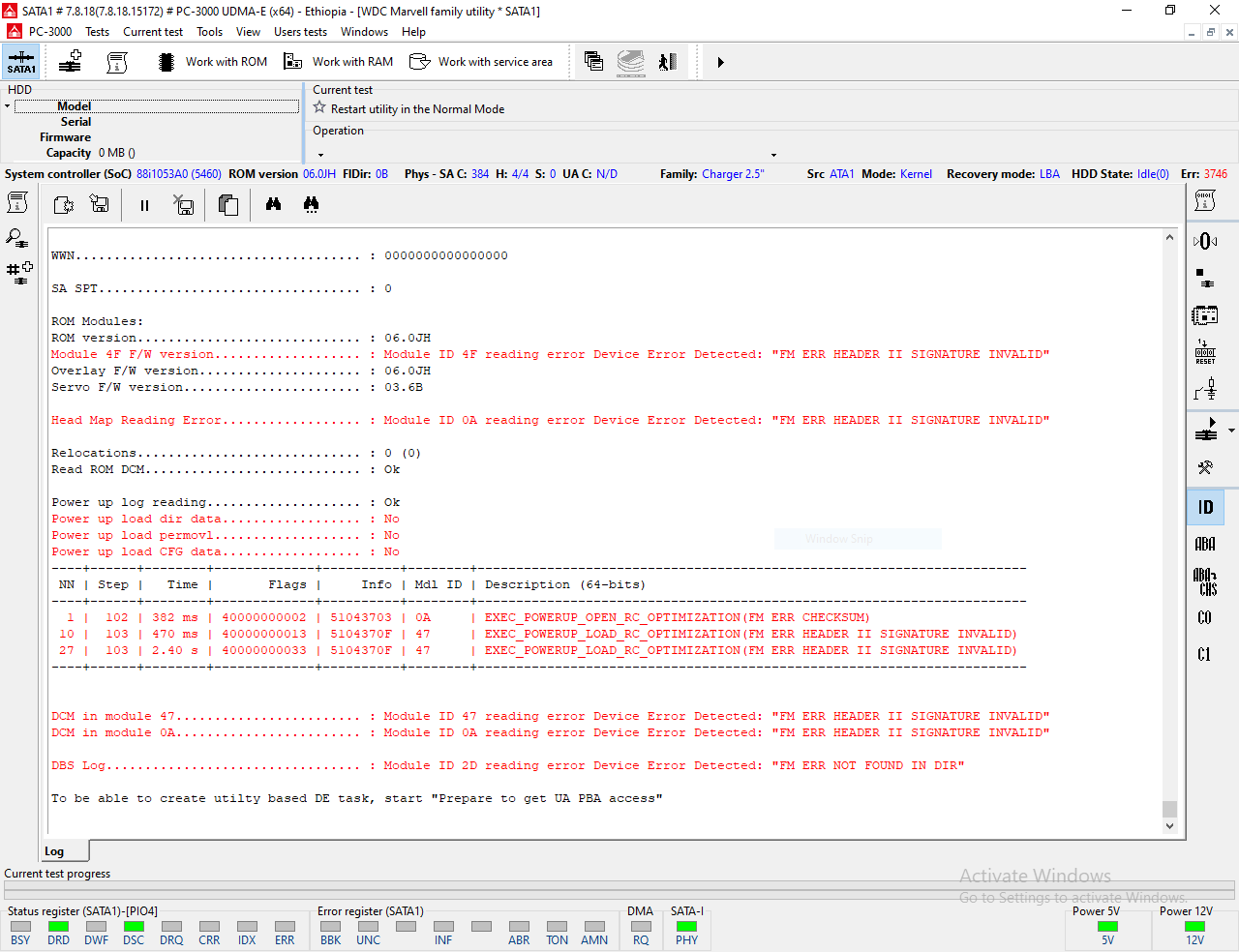

Can anybody tell me how to check ROM is Native or may be i have dropped the ball somewhere in the process of unlocking it. Please help.
Native ROM.PNG (78.65 KiB) Viewed 1144 times
